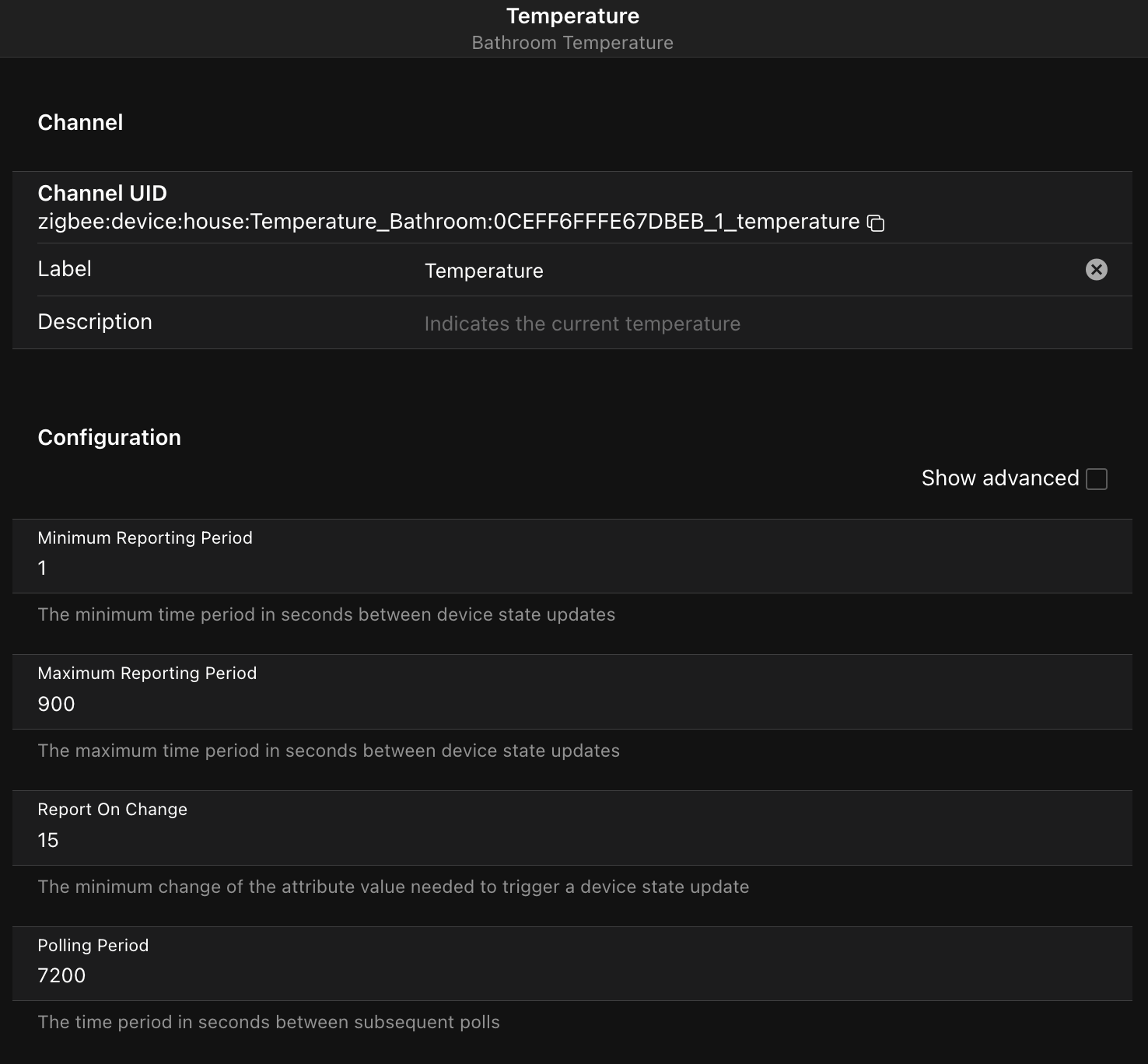

This solution helped me. It’s a pity that the working setting is not implemented in the UI

If you want to change the reporting period of these sensors, it can be done through the UI. This is available in the channel configuration. Or maybe I’ve misunderstood the question and you’re looking for something else?
Thanks, I have set the polling timings. This is like a temporary solution. I’m trying to figure out why the sensors started sending data every 10 seconds. I’ll change the batteries when I get home.
