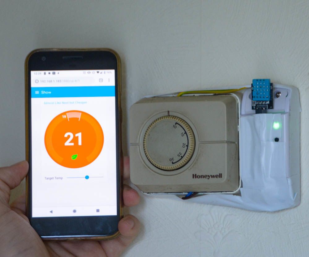

I’ve just started making my own WiFi thermostats to run alongside my standard wall thermostat using sonoff basics and a dht11, it costs around £8 and works like a nest system.
Let me know if this is something you’re after and I’ll share my setup with you.

just buy a dht11 (ebay £1), sonoff basic (ebay £5) and a room sensor enclosure ( RS components (£3.50)
the most expensive part is your time learning openhab and mqtt. Once you get you head around that the world is your oyster.
