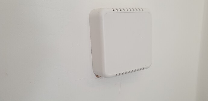

I have 12 underfloor heating zones that i upgraded around 1 year ago. I had the old 220v 3 wire analog thermostats in each room that needed updating. I did this using very cheap sonoff basic switches, and wired a dht11 temp sensor to the spare gpio on the board. The 3 wires on the thermostats are basically on and off. I flashed the sonoff basics with tasmota and use mqtt and openhab to control the heating. Its actually incredibly simple system as you just need it to turn on and off when it gets to your desired temperature in my case 21c. I have additional sonoff zigbee temperatre sensors in each room so I can get an average temperature in each room as the thermostat was 1 0r 2 degrees higher and the second thermostat is the same but lower. If you have lamps with sonoff basic switches on them then they can also be your second temperature sensor. In my opinion or situation, there is no need for a display as it should always be 21c or above. Each thermostat probably cost £10-£15 each to make you just need a sonoff basic £5, a dht11 temp sensor £2, and a sensor wall box £7. There is a great feed on here called Boilerplate, I recommend reading that and I’m more than happy to share my items, rules, things files.

This is actually really interesting. If I understand this correctly you are simply using a switch that is controlled by oH, and a temperature sensor value reported to oH, and the rest is software. The main difference to the full blown thermostats is that it does not work standalone. But that is more of a bonus for me, as it gives you full flexibility, and my openhab on the pi4 has been running rock solid without any issues at all. It is even rather simple to implement the switch between heating and cooling mode.
I am almost sold on that idea already. Lets see if anybody has another, ready made solution, but this here is definitely something I could imagine to implement.

The best thing to do is make a test switch and run it in a room that doesn’t matter if it fails. I’ve still got the old analogue switches in the bedrooms and the new switches ‘piggy backing’ them so if they fail then at least the old ones will kick in. They work flawlessly.
