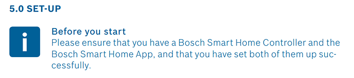

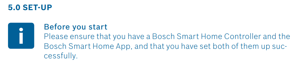

Again, it depends on the thermostat. Some have WiFi or Z-Wave built in, in which case there’s no hub. It’s up to the company. More importantly, thermostats differ by region, and could mean valves that control individual radiators or wall-mounted displays that control forced-air systems or electric baseboards.
You need to find out what’s available in your area and then search in the documentation/community to see if it works with openHAB.
Actually, a light or switch that uses WiFi still requires a hub: your WiFi access point. Whether it’s Bluetooth, NFC, ZigBee, Z-Wave, or something else, devices can only talk to other devices that speak the same language. The hubs you’re referring to are necessary to translate one language into another.
