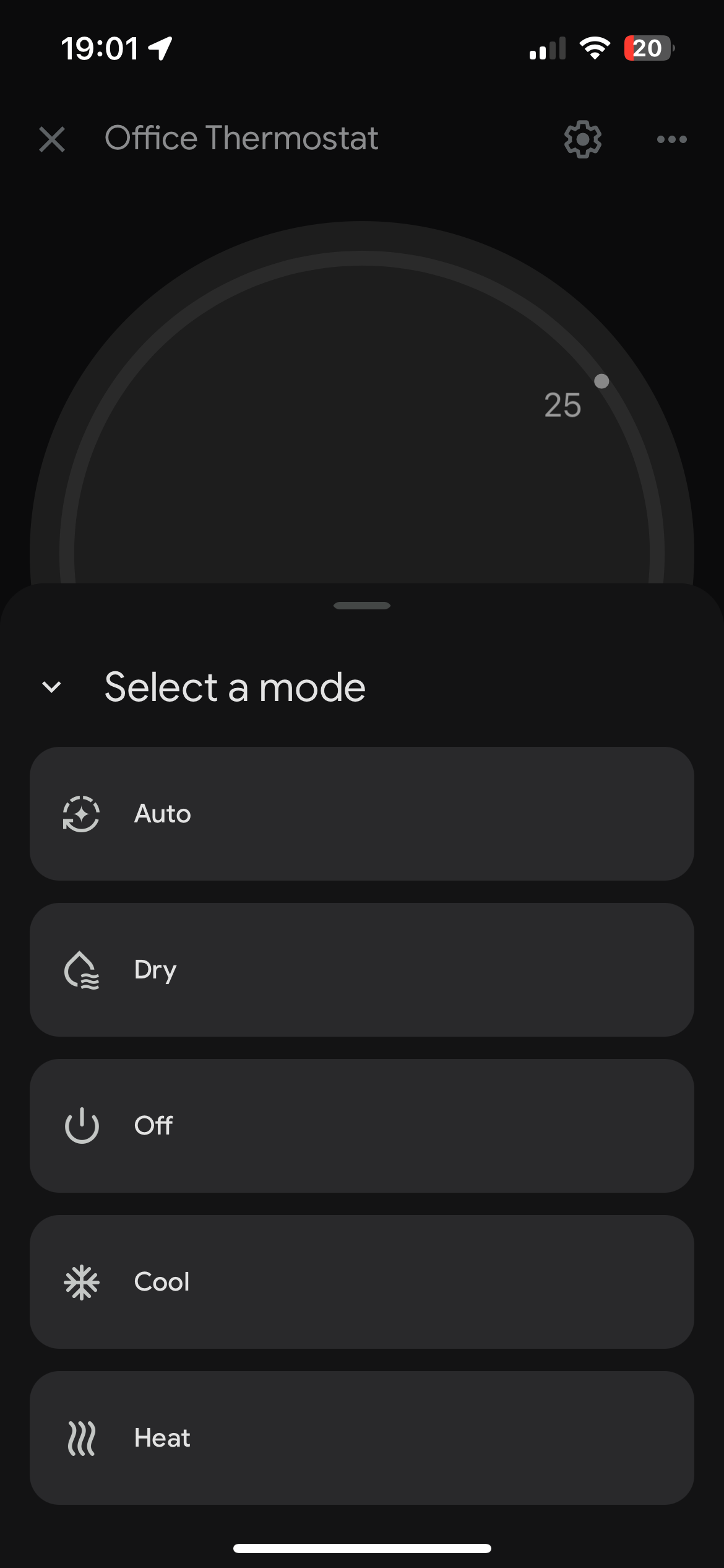

Sorry to hijack the thread but I’m also seeing some weird behavior on Google assistant side.
I’ve edited the metadata code, but some modes are not showing, the mode isn’t showing on Google home app, there’s information missing and overall the entire thing appears quite buggy,
value: Thermostat
  thermostatModes: off,auto=heat_cool,cool,fan=fan_only,dry,heat
  useFahrenheit: false
  thermostatTemperatureRange: 4,35
My thermostat ^
And this is what I see in Google home :
Missing mode in Google home -
Missing “fan” mode option inside of thermostat in Google home:

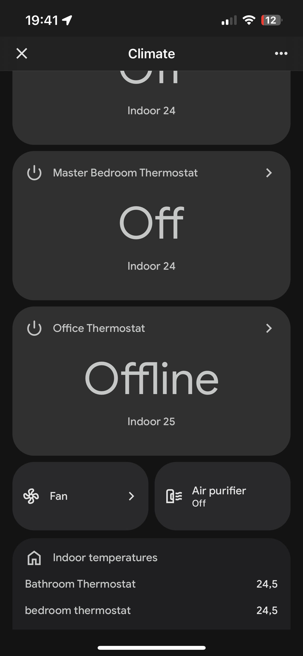

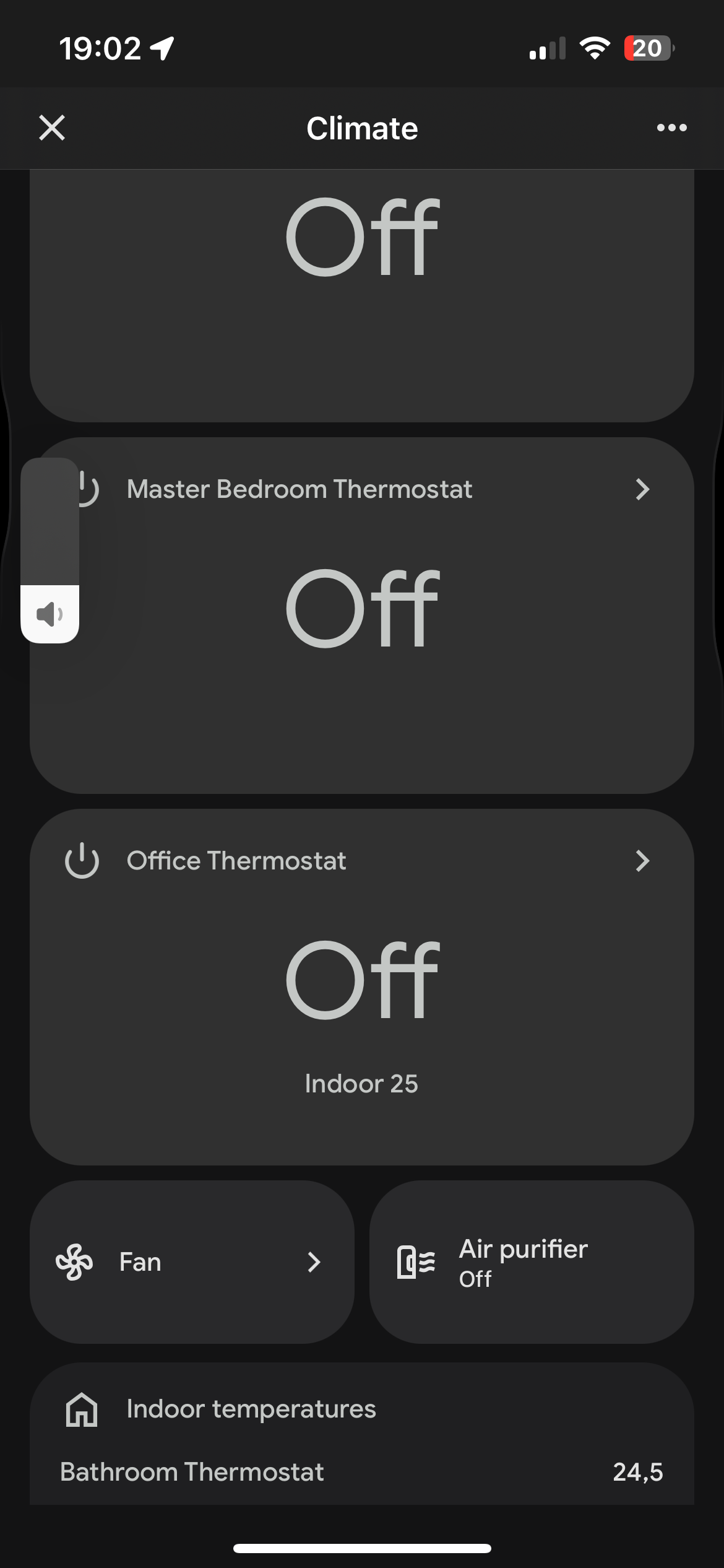

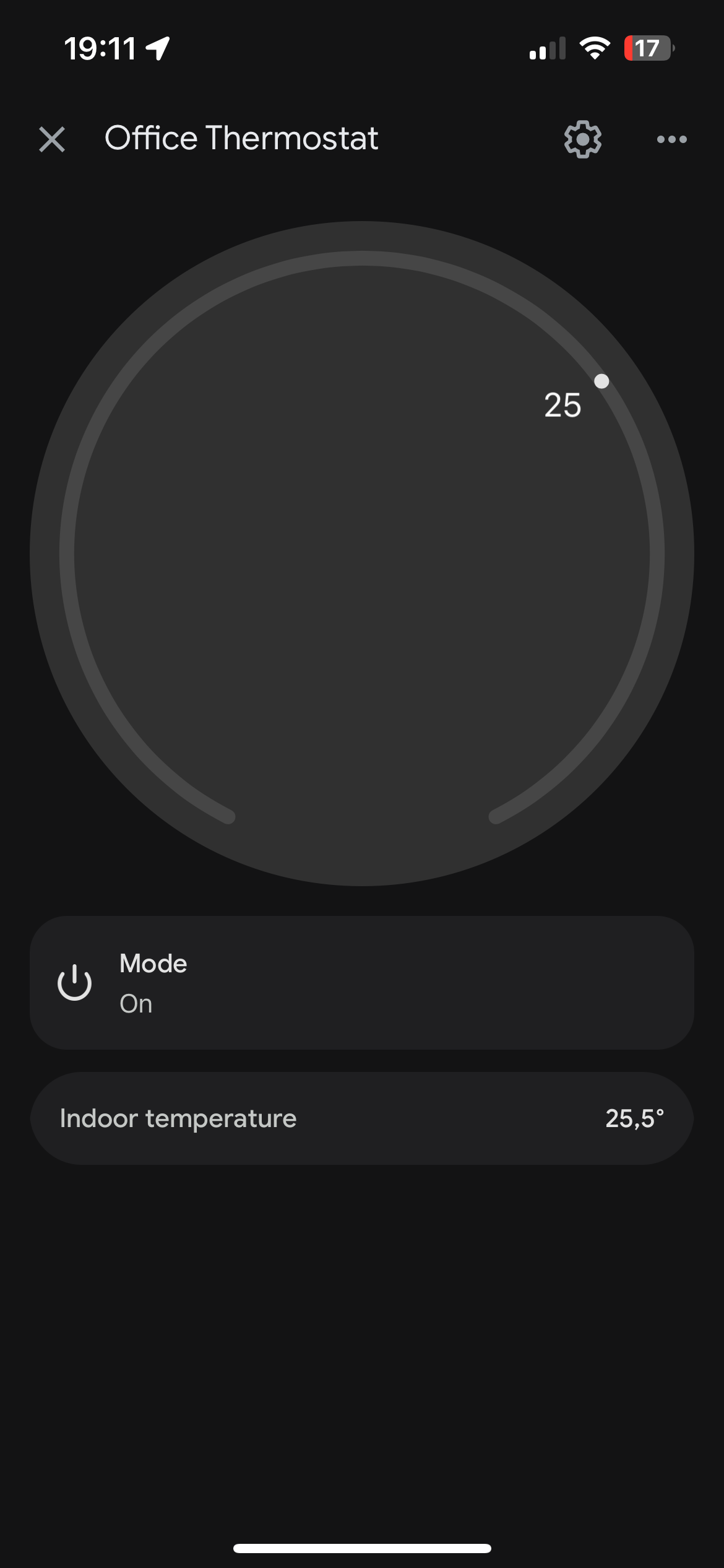

Now I have the mode “off” but inside of the thermostat it says “on” ?!
Outside of the thermostat it says off, but inside says on, but I don’t have ano “on” mode?
It’s super weird because sometimes I see the thermostat in Google home as “off” or “offline”. Then I enter the thermostat and it’s “on” (??) but I don’t have an on state…
