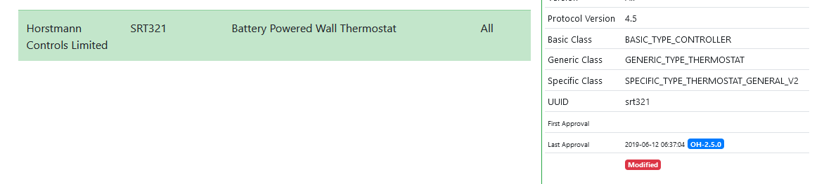

The database entry was modified:
Whoever made the modifications should request a review. After approval and after installation of the latest Z-Wave snapshot the device should be recognized again.

Could you ask the user who changed the database entries (SRT321 (0059:0001:0005) and SRT323 (0059:0001:0004)) to request a review?
I can’t do this - no. This device has not been edited since 2019 so hasn’t changed since we moved to the new database - it means these devices are not so common as they won’t have been in the binding for over 2 years
I will push these out shortly though.
