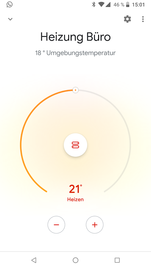

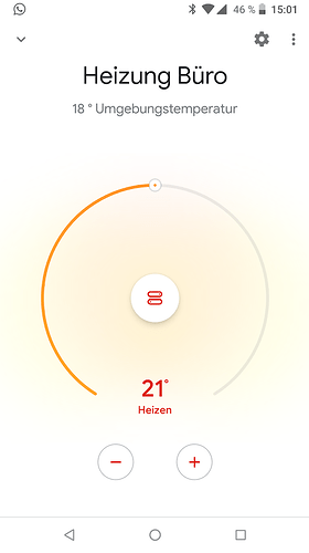

This configuration works well, and if scan in Google Home, I can see the current temperature, select the set point temperature and ask for the current temperature. This works both in the app and with voice commands. I can also switch the thermostat on (“heat” or “auto”) and off (“off”).
The same device is found in the Alexa app, but not fully functional. It is reconized as a Thermostat. Via voice, I can also choose a set temperature or ask for the current temperature. Still, I cannot choose a mode. When I say (in German) “Alexa, switch the heating off”, it responds “The thermostat heating does not support this”. Also in the app, I see only the device properties, not the UI for a thermostate (choose a set value, check the current temperature, swiching to heat or off).
So while Google does recognize a fully functional thermostate, Alexa has issues. Can someone help?
Alexa App
Google Home
