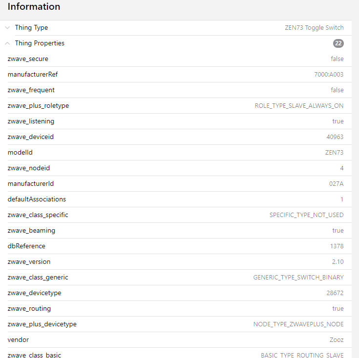

no. Does the UI page properties dropdown look ok? Numbers all match there too? This is for a Zen73

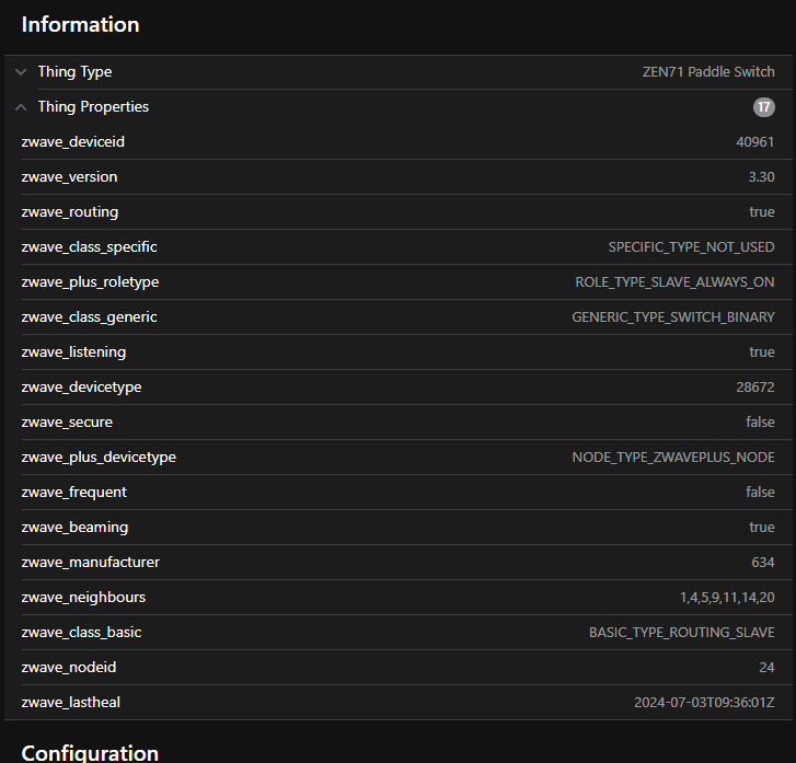

Here are the properties of the ZEN71 in question
Haven’t analyzed it in detail for comparison but what stands out is that mine does not list ManufacturerRef in properties. Why might this be missing?
I have also have ZEN77 and ZEN72 devices working as expected and do show ManufacturerRef property entries.
There are a few other differences as well but not sure if implicated.
I don’t see much that could be wrong. It is missing the dbReference that should be 1340, but there is too much else correct. Maybe the debug will show something. I’m actually at a loss at this point
ManufacturerRef is just the type:ID in hex. The decimal numbers under deviceid and devicetype match, as does the manufacturer (027A = 634)
