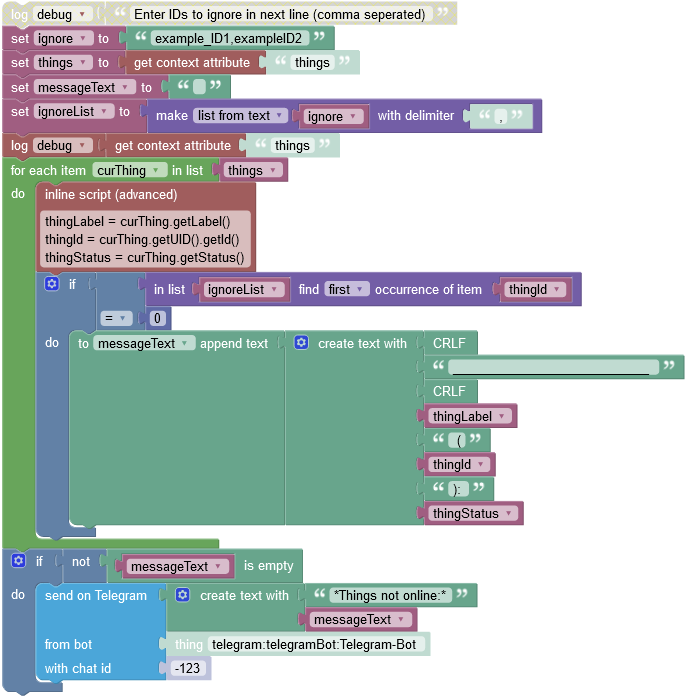

Thing Status Reporting [3.2.0;3.4.9]
It was ecma 21 in text based script action.
Today I tried again in blockly and… it worked on the first try :flushed:. I cannot tell what I did wrong.
Now it works with your template rule. :slight_smile:
Here the code (for pasting in code-tab of new rule):
Click to see code

And the screenshot:
Thanks Rich for pointing me in the right direction.
ECMA 2021+ version of @Larsen blocky script.
