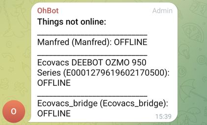

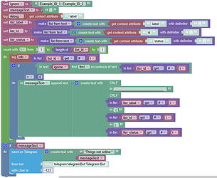

I changed/extended your rule a bit, especially since I wanted to see readable names (labels) of the offline things… but then I did a little bit more… Maybe you can use something for your next revision, or somebody else likes it. I thought the whole solution might be nice for the marketplace but I didn’t want to steal Rich’s code. Tell me if it’s better to start a new thread. The changes are:
  • Filter all things that are not ONLINE or UNINITIALIZED (to see things with initialisation problems too. You get the things with status INITIALIZING, OFFLINE, REMOVED, REMOVING, UNKNOWN for further processing.
  • Export of labels, IDs and status. (As far as I understand, the values of the context hashmap are passed as strings. Please tell me if there is a better way than passing as arrays)
  • evaluation rule with Ignore-list for things to be skipped, that sends telegram messages when things are offline (love it).
Cron-rule with changes at the end

evaluation rule (blockly). To use paste it in the code tab of an empty rule

The blocky rule should look like this. You need the telegram binding and the telegram-with-chat-ids blockly library from the marketplace. Finally you have to change the bot and chat-id to your needs (see doc of telegram binding).
If everything works well the telegram message look like this:
Hope you like it. Comments/hints/improvements are welcome.

The Blockly rule you’ve posted is a good example of the sort of thing that can be done in response to being called though and with only minor modifications it should be able to work with the original, though you might need to use the script block to access the properties of the Thing Objects.
Note, when posting Blockly, post both a screen shot and the contents of the “code” tab in code fences.
code goes here
