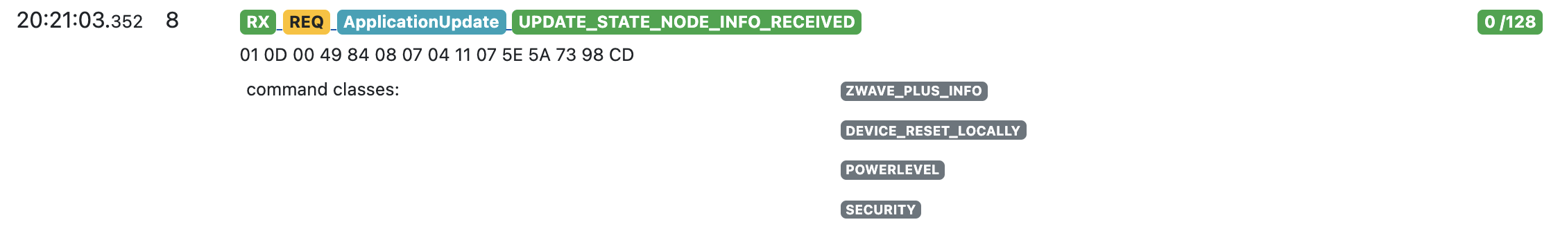

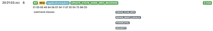

This is where the device reports what command classes it supports, and, well, it’s a short list. The binding relies on this list to decide what to do and how to configure the device and it’s why the initialisation stages drop through with nothing being sent -:
The only command here is the ZWave Plus Info class since all the others like manufacturer data etc are not listed as supported by the device.
It is possible to override this in the database - the problem of course is you can’t be 100% sure what the device is without getting the manufacturer information, so it’s a bit of a catch-22.
