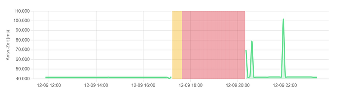

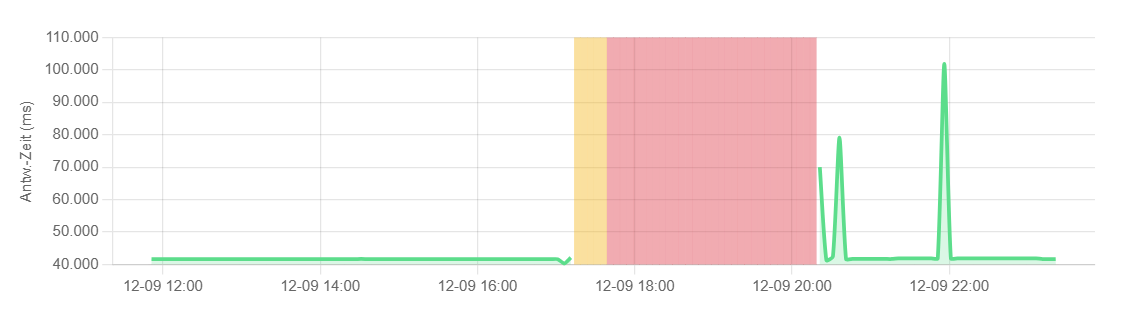

And this MQTT message are (as one example) stopped to be sent out when the issue occurs, which can be seen in Uptime Kuma:

That is what I did using Uptime Kuma. I’m tracking if messages appear on this channel, which should happen every minute. And if this does not happen, I raise a warning that “openHAB is broken”.
