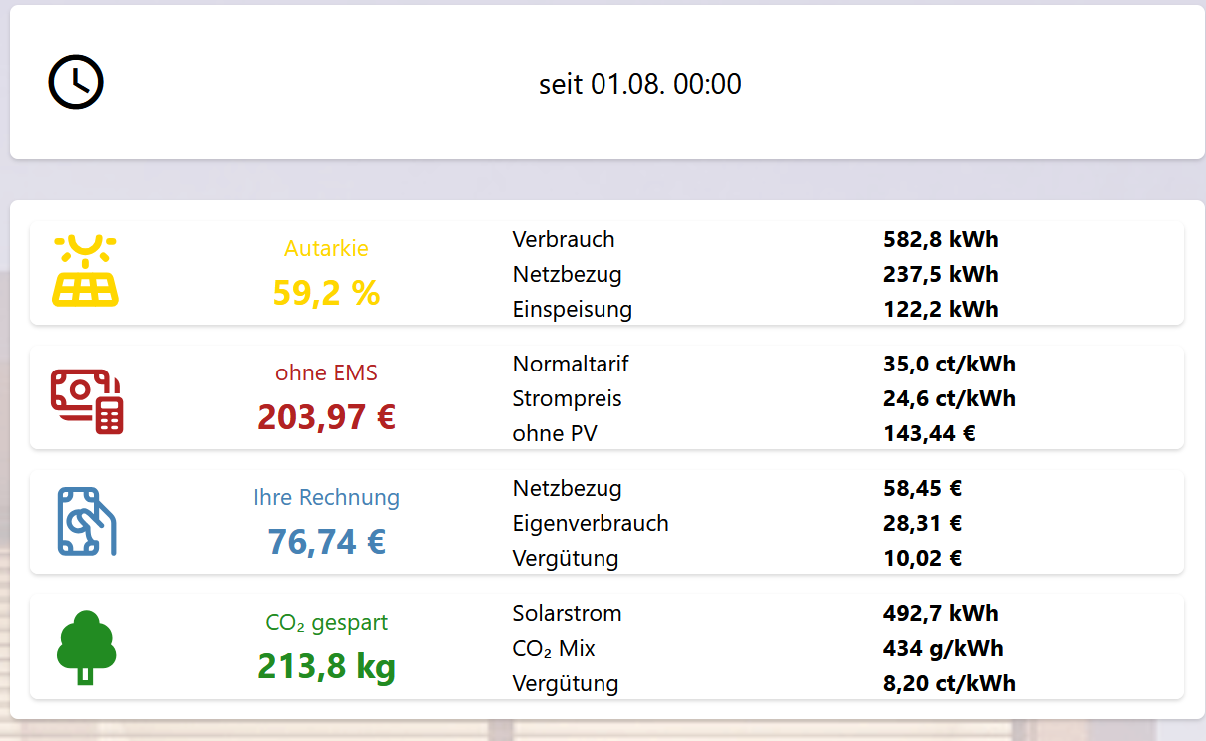

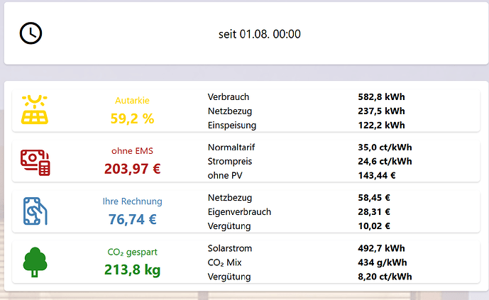

No long term stats, but here’s my month-to-date snapshot for December
It’s interesting as my home has a pretty common ‘average’ hardware setup. No EV.
12kW heat pump with average-sized buffers (300l+200l), solar plant (12kWp), consumption (4 persons).
Both reports are taken from my energy management system (commercial but openHAB based for those that wouldn’t know).
So it’s almost 25% savings compared to a fixed price tariff of 35ct which was the average value in Germany in 2023.
Also note the line doing the math “what-if-I-had-no-PV”. Tomorrow it’s winter solstice and this is showing how little a PV contributes at this time of the year. Post #11 in comparison gives an impression of how it looks like in spring with little heating needed.
Also, I’m in Germany where prices are much higher, particularly because of (fixed) transmission cost, so saving percentages don’t look as great as in Finland.

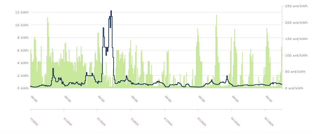

This January is going to be quite interesting for us because of the consumption factor agreement and the all-time high spot prices on Jan 5th.
Our contract is 8.8 +/- consumption factor. On Jan 5th the average price of the day was 110 c/kWh, which is about 10x compared to other days. Because we were able to reduce our consumption during the day, our consumption factor on a daily level was -34 c/kWh. Of course this will not be the factor for the whole month but for Jan 1 - Jan 6 period we are at -10.0 meaning that if the month would end now, we would not pay a dime.
I would guestimate that the whole month’s consumption factor will land somewhere on the ballbark of -5 so we would pay 8.8-5=3.8 c/kWh. The January average market price is 33 c/kWh at the moment but it will come down because Jan 5th pulls the average heavily at the moment but in any case the consumption factor agreement is going to beat a pure spot price contract on this particular month quite much (we will pay it back on summer months when the market price is less than 8.8 c/kWh, though).
Black line in the picture is spot price in c/kWh and green bars are our consumption. We had a huge anomaly in the spot price 5.1.2024, highest price ever in Finland.
Looking at the graph it seems obvious we were able to dodge the bullet with OpenHAB. The house was heated in the preceding night with a long heating period and then everything shut down while the price was high.
Money saved!
