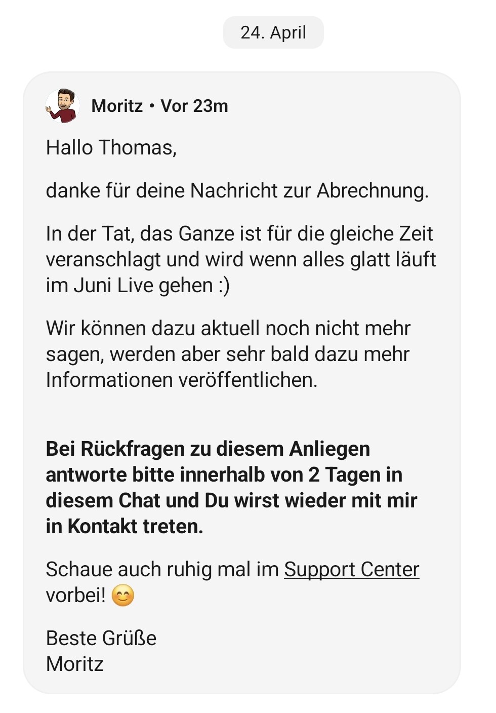

Sorry, this is German only (screenhot within the Tibber App), but basically says if all goes along well as planned, there’s the 15 MTU live in June also in Germany and there’s more info coming soon:
Screenshot_20250424_143130_Tibber
