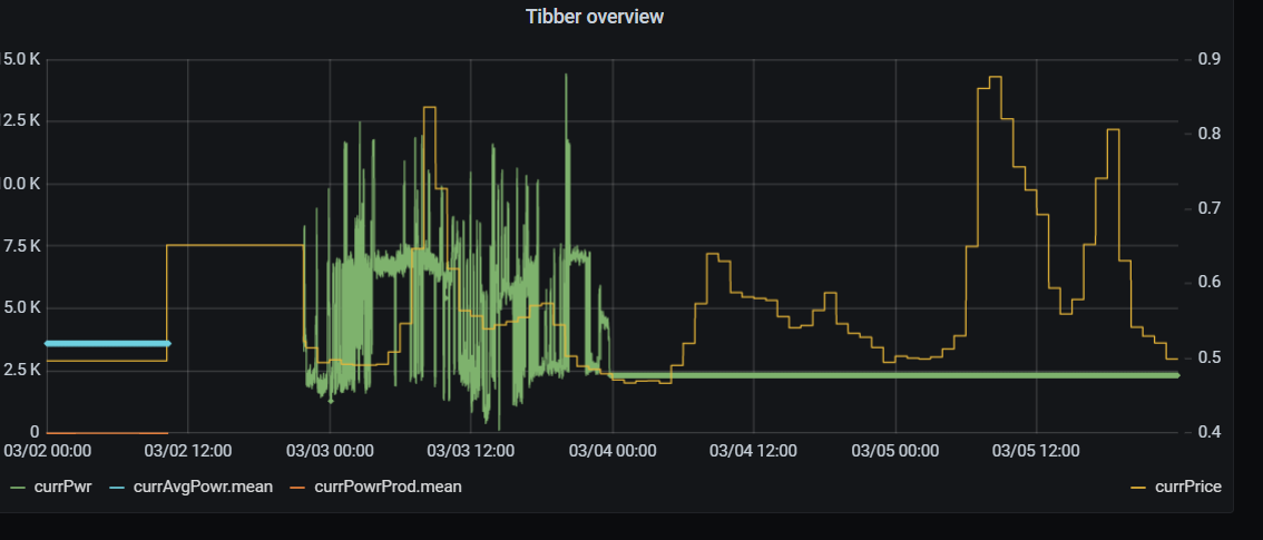

I experience some issues with the tibber binding in OH 3.0.1:
I can read e.g. current price and current consumption perfectly for a while, but suddenly consumption is lost, while I still get the current price:

So it looks like sometimes the binding manages to reconnect, but later it only times out.
In the tibber app, however, I still see current consumption, so nothing seems to be wrong with the Pulse.
