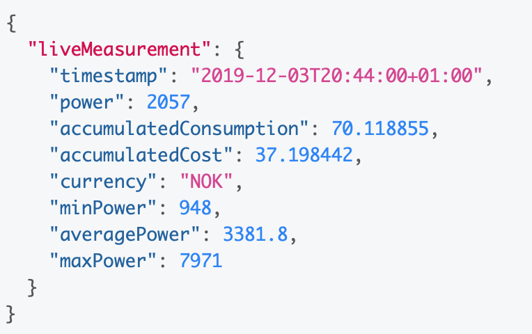

Based on your log, you get connected, but as part of connection_init request to actually start data stream, Tibber API responds with error in its first response message. This would point in the direction of incorrect token used in the setup.
However, the binding might not be set up to handle multiple homes, so for sure, this could be an issue.
Also, using “personal token”, choosing “Real time subscription” from dropdown menu, what is the result when running subscription (see my example below)?
Then I have prepared a new version of the binding to be able to handle multiple HomeIds / Pulse. Now the user has to define both Tibber token and Tibber HomeId as part of OpenHab setup. Desired HomeId to be used as input in OpenHab could be found from https://developer.tibber.com/explorer: Sign in with your account, load personal token, and run query as shown below:
