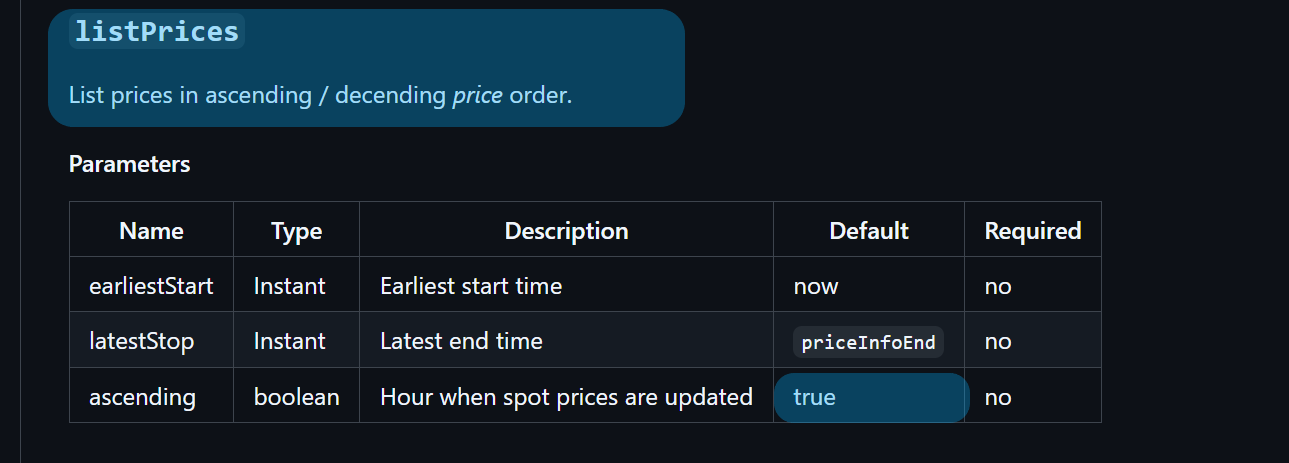

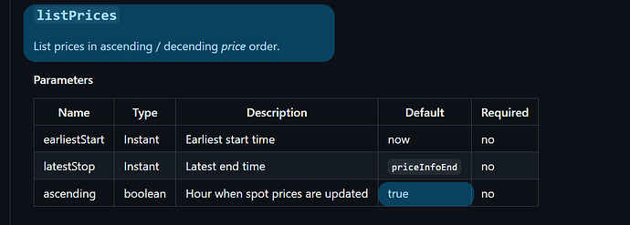

priceList
returns the priceList, but if I leave the parameters empty [‘{}’], it won’t list the next starting point (presently in hourly-mode at 10:45h it should be starting off with 11:00h, but the response starts at 12:00h having 11:00h somewhere in the middle?: )
  "size": 14,
  "priceList": [
      "price": 0.124,
      "duration": 3600,
      "level": -2,
      "startsAt": "2025-06-23T12:00:00Z"
      "price": 0.1241,
      "duration": 3600,
      "level": -2,
      "startsAt": "2025-06-23T13:00:00Z"
      "price": 0.1315,
      "duration": 3600,
      "level": -2,
      "startsAt": "2025-06-23T11:00:00Z"
      "price": 0.1333,
      "duration": 3600,
      "level": -2,
      "startsAt": "2025-06-23T14:00:00Z"
having it listed with {"ascending": true} the 11:00h was sorted an hour earlier after 13:00h, but still not at the first position. :wink:
