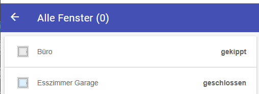

Here’s a sample definition and the corresponding view in OH:

As you can see, even though office window is tilted, the quantity of open windows is 0. Any help to treat this as OPEN, would be appreciated. Btw, I’m still on 2.3 :slight_smile:
