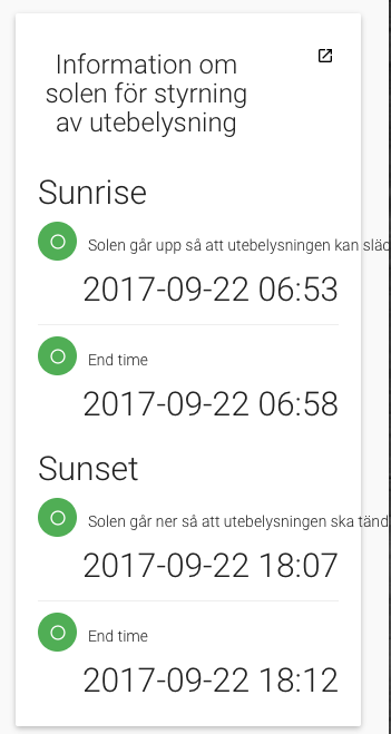

I am using two instances of the astro binding, one vanilla one and one with an offset of +/- 30 minutes applied to sunrise/sunset so that lamps may turn on before it’s totally dark outside.
The adjusted binding seems ok:
