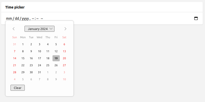

I use oh-input to input time from the main web GUI. Today I looked at the screen for time input and the little clock symbol isn’t there anymore to allow for input. The item tied to the widget is null and that that might have something to do with it (still fumbling around with how to set it without the GUI). I went to the widget editor and put in both time and time/date pickers but they don’t let you input time either. The time editor is below and doesn’t show the edit button. The date/time is the second example and while the calendar pops up it doesn’t have the time section. Am I doing something wrong or is this a bug?
component: oh-input-card
  title: Time picker
  type: time
  sendButton: true
  useDisplayState: true
  showTime: true
  title: Time picker
  type: datetime-local
  sendButton: true
  showTime: true
It is not immediately clear. When I use the sample cope you provide, I get the clock icon and can set time. I am also on 4.1.1. So it is not a universal issue.
What browser are you using to view these widgets?
