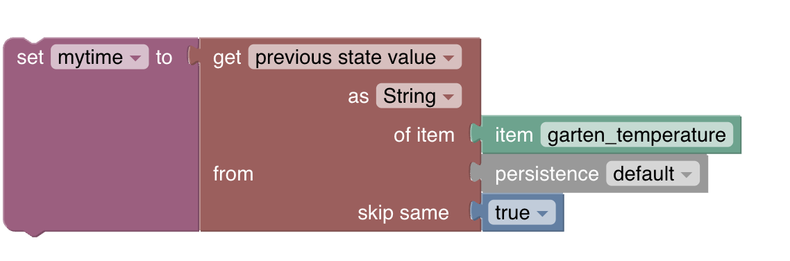

In jsscripting (which is generated by blockly) you can just do
var mytime = items.getItem(‘garten_temperature’).persistence.previousState(true)?.state;
What exactly do you want to do with the time?
