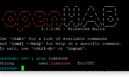

In OH2 it is possible to check the timezone in the karaf console with
env | grep timezone
does this show the same timezone in your case ?
Hi Wolfgang,
Just checked that in Karaf. It shows UTC timezone where i need CET.
How to change this?
