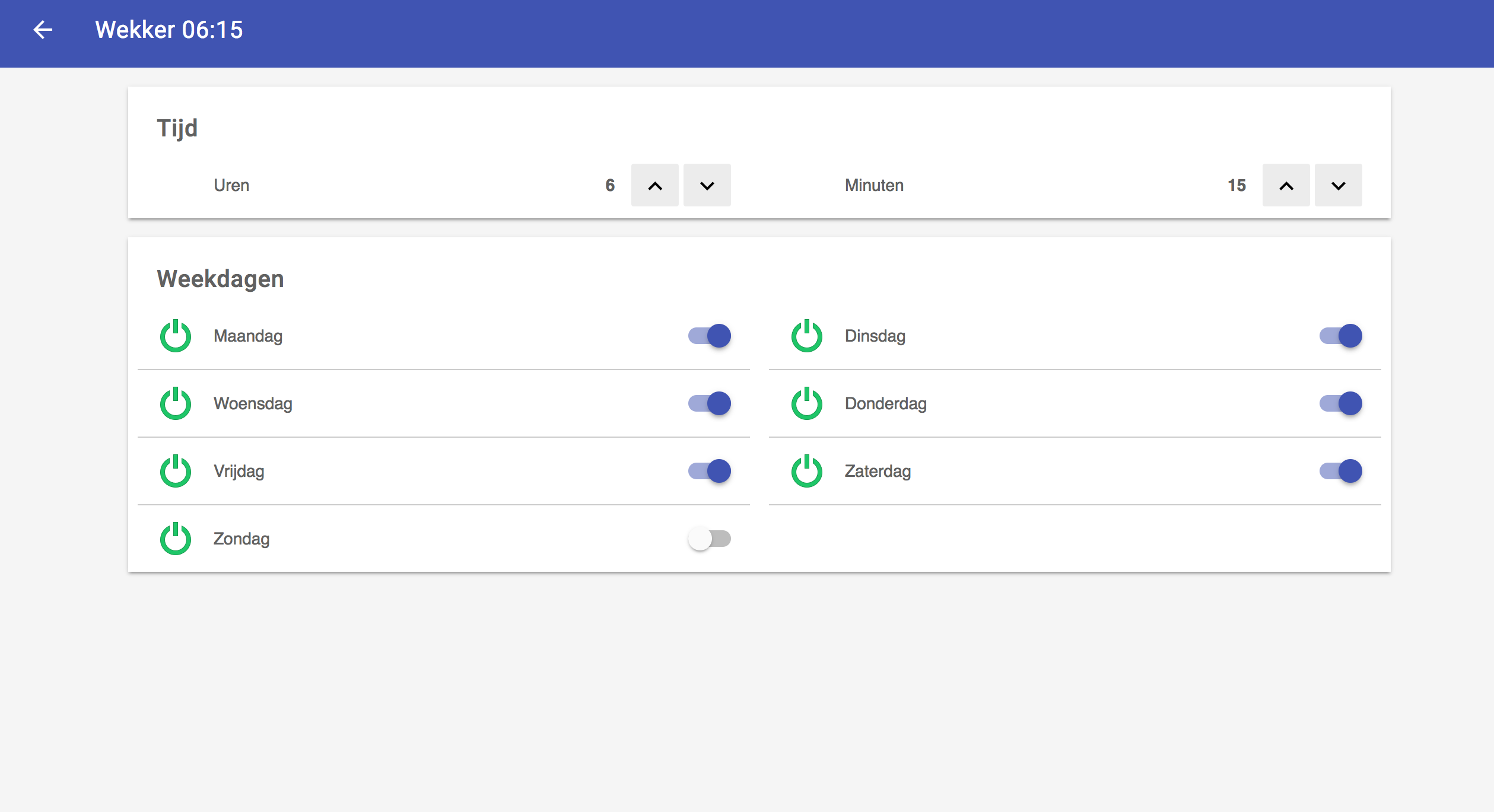

The final result:
That looks so much more complicated than anything else Ive seen lol.
Also makes me think doing that, I might as well carry on with my idea of making a python program to do it and distribute it on MQTT periodically.
set it up once to your likings, rince and repeat… :slight_smile:
It’s not complicated… not more complicated than having an external python script triggering stuff over MQTT…
So you have all that set up for starting a timer, or to post a ‘start’ signal and then post a ‘stop’ signal some time later? So for multiple schedules, you repeat this for as many as you need?

                (TimerMorningWeekendMinute.state as DecimalType).intValue
    var int nowMinute
    nowMinute = now.getMinuteOfDay
    var int delta1
    delta1 = (minuteTimeWD - nowMinute)
    delta1 = delta1
    var int delta2
    delta2 = (minuteTimeWE - nowMinute)
    delta2 = delta2
    if (nowMinute >= minuteTimeWD) { delta1 = delta1 + 1440 }
    if (nowMinute >= minuteTimeWE) { delta2 = delta2 + 1440 }
    var int deltaFinal = 0
    if (delta1 < delta2) {
        deltaFinal = delta1
    } else {
        deltaFinal = delta2
    return deltaFinal
  lockMorning.lock()
  try {
    if (timerMorning !== null) {
      logInfo('TimerMorning', "Cancelling old timer");
      timerMorning.cancel
      timerMorning = null
        deltaFinal = getNextExecutionInMinutes.apply()
    logInfo('TimerMorning', "Setting up timer delta to " + deltaFinal.toString() + "minutes from now");
    timerMorning = createTimer(now.plusMinutes(deltaFinal), [|
        var Number day = now.getDayOfWeek
        if (
            TimerMorningEnabled.state == ON &&
              ((day < 6) && (TimerMorningWeekdayEnabled.state == ON)) ||
              ((day >= 6) && (TimerMorningWeekendEnabled.state == ON))
          logInfo('TimerMorning', 'Alarm Clock wake up time triggered')
          // perform actions
          if(TimerMorningCoffee.state == ON) {
            logInfo('TimerMorning', 'Turning on coffee station')
            CoffeeStation_Plug.sendCommand(ON)
          if(TimerMorningWakeUpLights.state == ON) {
            logInfo('TimerMorning', 'Turning on lights')
            AT_Bedroom_Light.sendCommand(ON)
            AT_Bedroom_LightStrip_Color.sendCommand(ON)
          if(TimerMorningShuttersAll.state == ON) {
            logInfo('TimerMorning', 'Rolling up all shutters')
            gShutter.members.forEach[ i | i.sendCommand(0) ]
          } else {
            if(TimerMorningShuttersBedroom.state == ON) {
              logInfo('TimerMorning', 'Rolling up bedroom shutters')
              AT_Bedroom_Shutter1.sendCommand('UP')
              AT_Bedroom_Shutter2.sendCommand('UP')
        if(TimerMorningTV.state == ON) {
          LGWallpaperTV_Power.sendCommand(ON)
          LGWallpaperTV_Mute.sendCommand(ON)
          Thread::sleep(5000)
          LGWallpaperTV_Application.sendCommand("com.webos.app.livetv")
          LGWallpaperTV_Volume.sendCommand(10)
          Thread::sleep(2000)
          LGWallpaperTV_Channel.sendCommand("3_7_5_0_112_1204_1")
        var deltaNext = getNextExecutionInMinutes.apply();
        if(deltaNext == 0)
                deltaNext = 1440
        logInfo('TimerMorning', "Rescheduling timer to " + deltaNext.toString() + "minutes from now");
        timerMorning.reschedule(now.plusMinutes(deltaNext))
  } finally  {
     lockMorning.unlock()
RESULT
