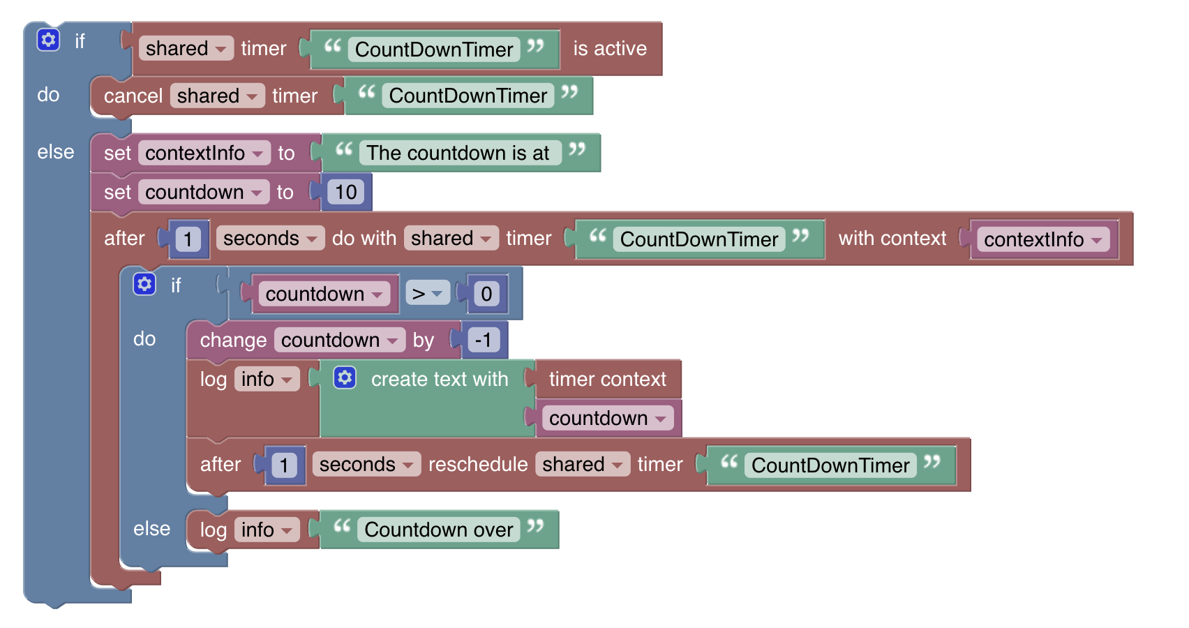

This is how you can achieve the same but granted, this is far from being as elegant as the block that Rich has provided.
By the way, as a sidenote I added this if-branch to show a pattern that I highly recommend when testing: it allows the timer to be stopped in case you have a bug in you loop which never ends (this approach also works for a private timer) - alternatively you can make it shared (like I did) and stop it from a different rule..
