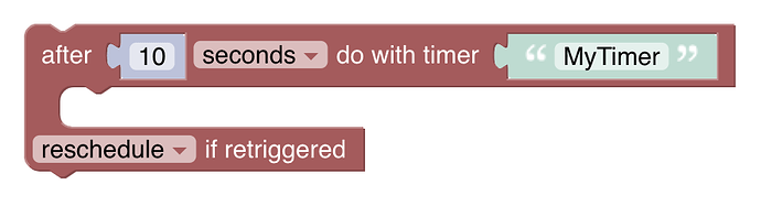

If so you probably need to use a different block:
You can choose what to do with the Timer when the rule runs again. You probably want to reschedule.

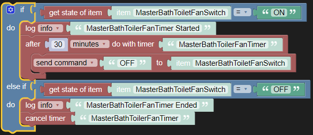

I use a “changed” trigger, then:
I don’t know if the timer persists after shutting off the fan, doesn’t seem to. This also cancels timer if manually turned off at switch.
