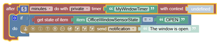

I want to create a rule that starts a 5 min timer, when a window opens and send an alert via a notification, when the window is still open after 5 minutes. Can anyone point me towards an example with javascript in a rule?
Why not create it with Blockly and study the code it produces ?
Trying it in Blockly and looking at the code is an excellent suggestion. In addition:
…and the generated code:
if (cache.private.exists('MyWindowTimer') === false || cache.private.get('MyWindowTimer').hasTerminated()) {
  cache.private.put('MyWindowTimer', actions.ScriptExecution.createTimer('MyWindowTimer', time.ZonedDateTime.now().plusMinutes(5), function (timer_context) {
    if (items.getItem('OfficeWindowSensorState').state == 'OPEN') {
      actions.notificationBuilder('The window is open.').send()
    }, undefined));
This will only give you one notification, but you can can retrigger, or cancel if need be.
