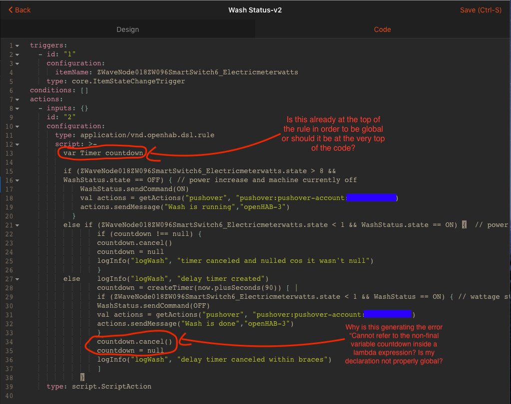

Hi, I have read umpteen articles on timers, but I’m still stuck after hours of fiddling & tweaking :frowning:
I’m on OH 3.
Scenario: Detect when wash definitely finished. Trigger rule whenever the power consumption changes, as it will during the wash cycle. Rule checks if power is down and the virtual switch ‘WashStatus’ is still ON… if true cancels any running timer, create a new timer, wait for 90 sec after which check again if power still down and WashStatus OFF. If true, then wash definitely finished so set WashStatus to OFF and send Pushover message.
I tested using a table lamp with sequence; Initially OFF - ON - OFF for 30sec - ON - OFF permanently.
Initial ON produces correct ‘wash running message’ ok.
Problems/errors:
If I move the second countdown cancel/null block to OUTSIDE the timer braces, the ‘Wash done’ message and the WashStatus OFF occur after only ~50 sec. Looks like the timer held onto the previous 30 seconds instead of cleanly restarting..?
A total of FOUR ‘delay timer created’ logs show up and FOUR ‘wash done’ pushover messages eventually arrive!!
If I move the second countdown/null block to INSIDE the timer braces, as in the screen shot, the script refuses to run at all with the error ‘Cannot refer to the non-final variable countdown inside a lambda expression’. I have seen forum solutions saying this is because the timer variable hasn’t been declared as ‘global’.
Hence my other highlighted query on screen shot, it the timer actually global where I’ve typed it? When I tried to ‘shoehorn’ it in at the very top of the code, I got loads of ‘block indentation’ errors. :exploding_head:
I’m truly demented by timers and all this chasing/cancelling/resetting.. they are like ‘trying to mind mice at a cross roads’ as the Irish saying goes. :roll_eyes:
Many thanks in advance for your patience and any solutions/suggestions.
Denis
Whilst you are defining the Timer at the start of your rule, it is not Global as it is stored within the context of the rule and gets reinitialized on every call to that rule. Unfortunately under v3 DSL rules do not support Global Variables - you can use another scripting language such as Javascript which allows you to use the ‘this’ keyword to make a somewhat global (it won’t be accessible from other rules as it still runs in the rule context).
The easiest workaround for now is to leave the rule in a ‘.rules’ file - you will lose editing ability from the UI but the rule will run correctly.

They are supported, just not in the UI. They still work as they always have though in .rules files.
Just to be clear, the significant change was in creating support for creating Rules DSL script actions in the MainUI at all. Rules DSL in .rules files remains the same. There are certain limitations of both the way that UI created rules are constructed and the Rules DSL language itself that makes it not wholly capable for UI created rules in all circumstances.
There is a feature called ScriptExtensions that I’ve not yet figured out how to use that might address this but I don’t know if ScriptExtensions are available from Rules DSL either. But these will let oyu share variables between rules regardless of the language it’s written in.
At a very high level, it’s because Rules DSL was never designed to be used in the way it’s used in UI created rules. The language itself lacks a number of features that would allow creation of timers like this to work. And since the language itself didn’t change between OH 2.5 and OH 3 it’s capabilities in the UI are somewhat limited.
And changing the language is not easy so it might be some time before one can access “global” variables in Rules DSL scripts.
As a general rule, if you have to ask “why can’t X just work” the answer is because you are vastly underestimating the complexity of the problem. Pretty much everyone who contributes to openHAB is competent and cares about usability. If something is hard for you as the user, it’s usually because it’s really hard for the developers to implement.
