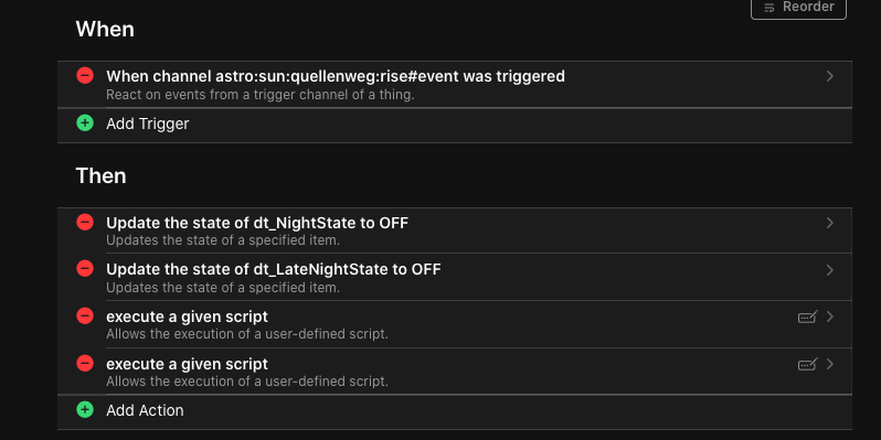

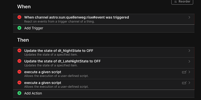

I am transitioning from text-based config and Rules-DSL to mostly UI. I got a fairly simple rule for day/time management (based on Rich’s stuff):
All it does it trigger on an Astro-event, set two items (and log this using JSScripting:
configuration: {}
triggers:
- id: "1"
configuration:
thingUID: astro:sun:quellenweg
event: START
channelUID: astro:sun:quellenweg:rise#event
type: core.ChannelEventTrigger
conditions: []
actions:
- inputs: {}
configuration:
itemName: dt_NightState
state: OFF
type: core.ItemStateUpdateAction
- inputs: {}
configuration:
itemName: dt_LateNightState
state: OFF
- inputs: {}
configuration:
type: application/javascript;version=ECMAScript-2021
script: >
console.log("NightState updated, --> NightState set to",
items.getItem("dt_NightState").state);
type: script.ScriptAction
- inputs: {}
configuration:
script: >
console.log("LateNightState updated, --> LateNightState set to",
items.getItem("dt_LateNightState").state);
So I am manipulating item-states in UI-rule actions and then want to access these in the scripts.
