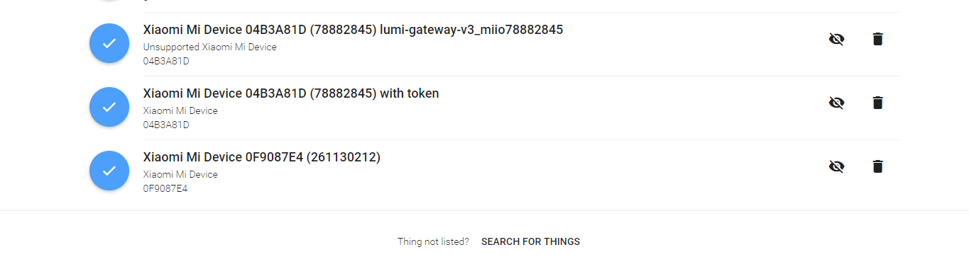

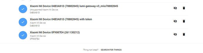

I have an older gateway. It´s connected trough the xiaomi (smart home binding).
But in my inbox I have 3 other devices, which appeared when I installed the Mi iO binding. Except for the gatway device, I have no idea what the other two devices are:
The first 2 are both related to your lumi gateway (there are 2 ways to discover these, that is causing the double entry, you can see they share the same deviceId / number between the brackets).
If you would enable the 2nd one (with token), you will see the token in the thing configuration.
