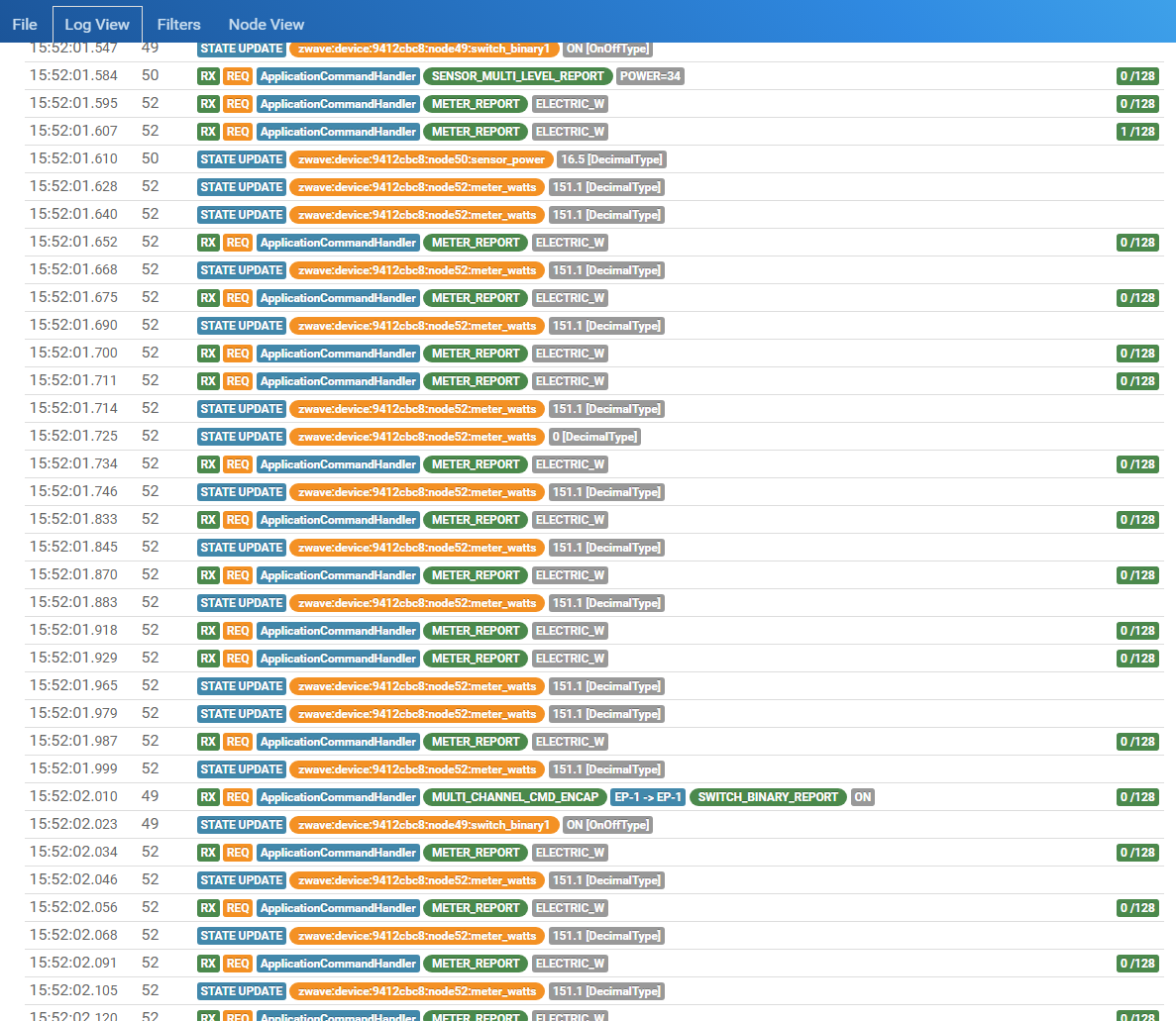

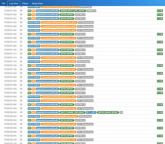

I have a few TKB Home TZ69 smart meter switches. Looking at debug data recently has shown a lot of dialog going on - see the traffic from node52 below about power usage:

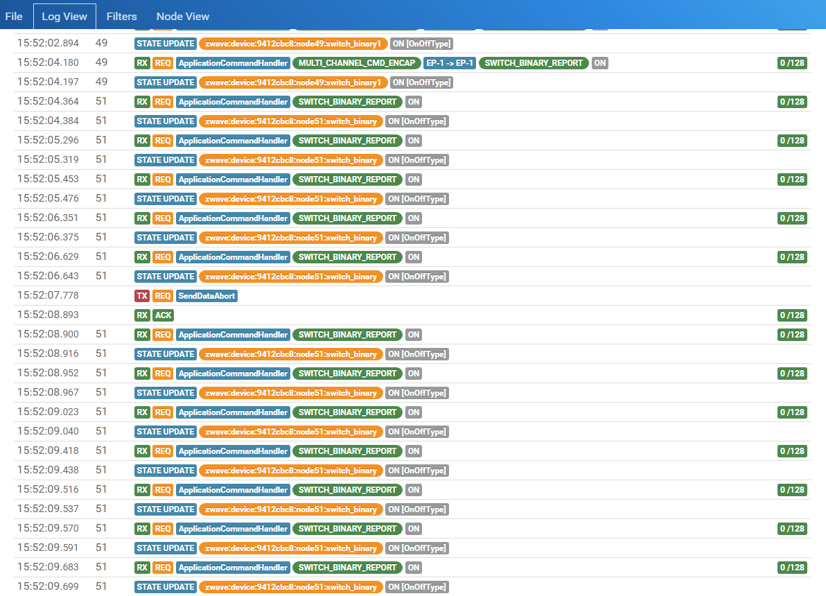

I get similar from all the TZ69 switches, below shows other repeat dialog:
Only association set is the lifeline to the controller.
Any recommendations on how to stop this or investigate further? Anyone else seen this?

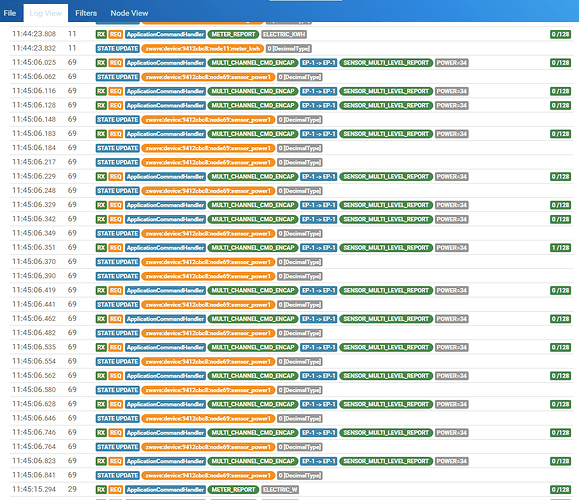

Back investigating this one… seems like i have a load of modules that are reporting multiple times according to the log cd-jackson viewer…

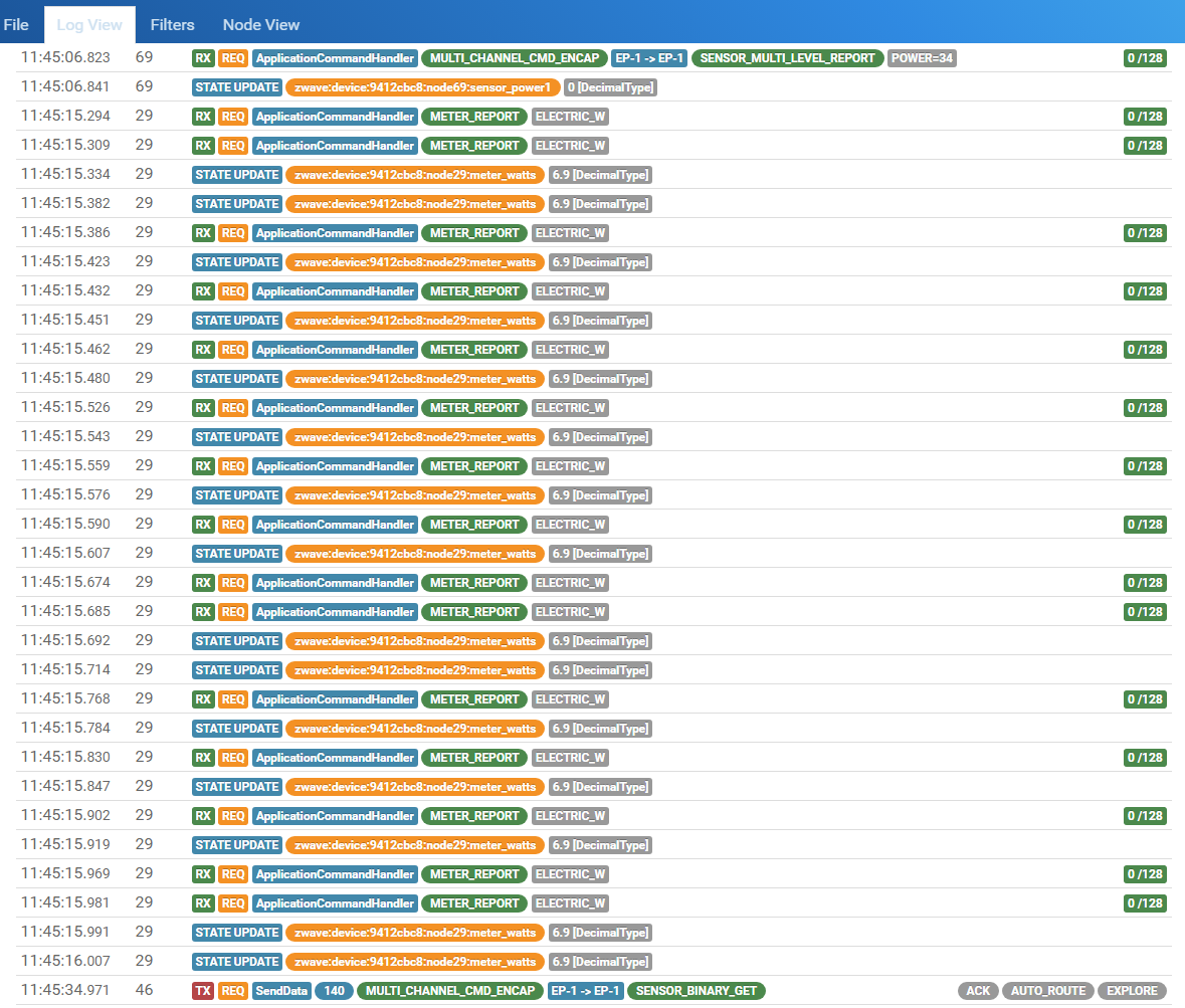

Node 29 (a TKB Home TZ69 switch) with lots of power updates…

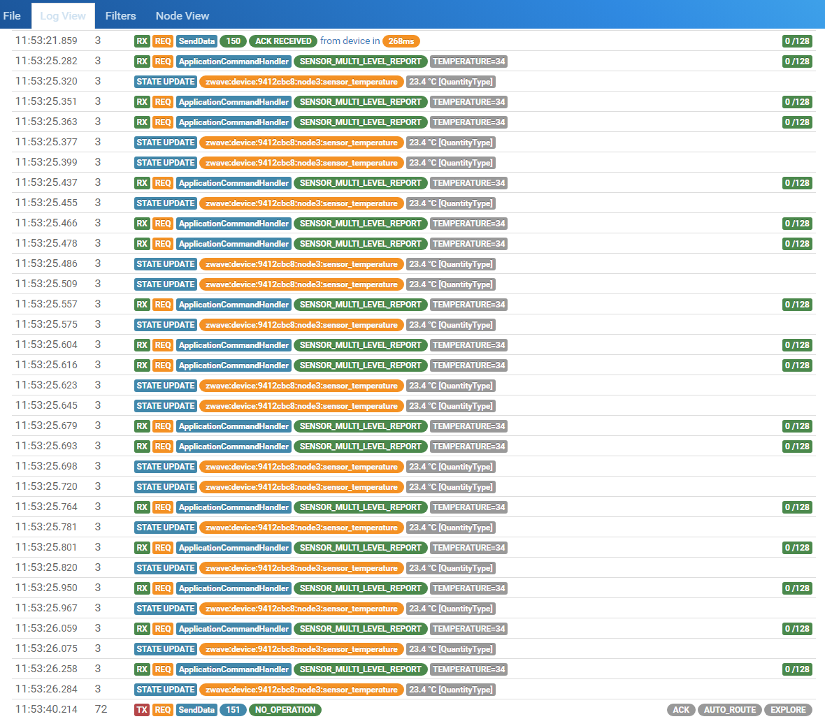

Node 3 (an Aeotec Multi-sensor) with lots of temperature updates…

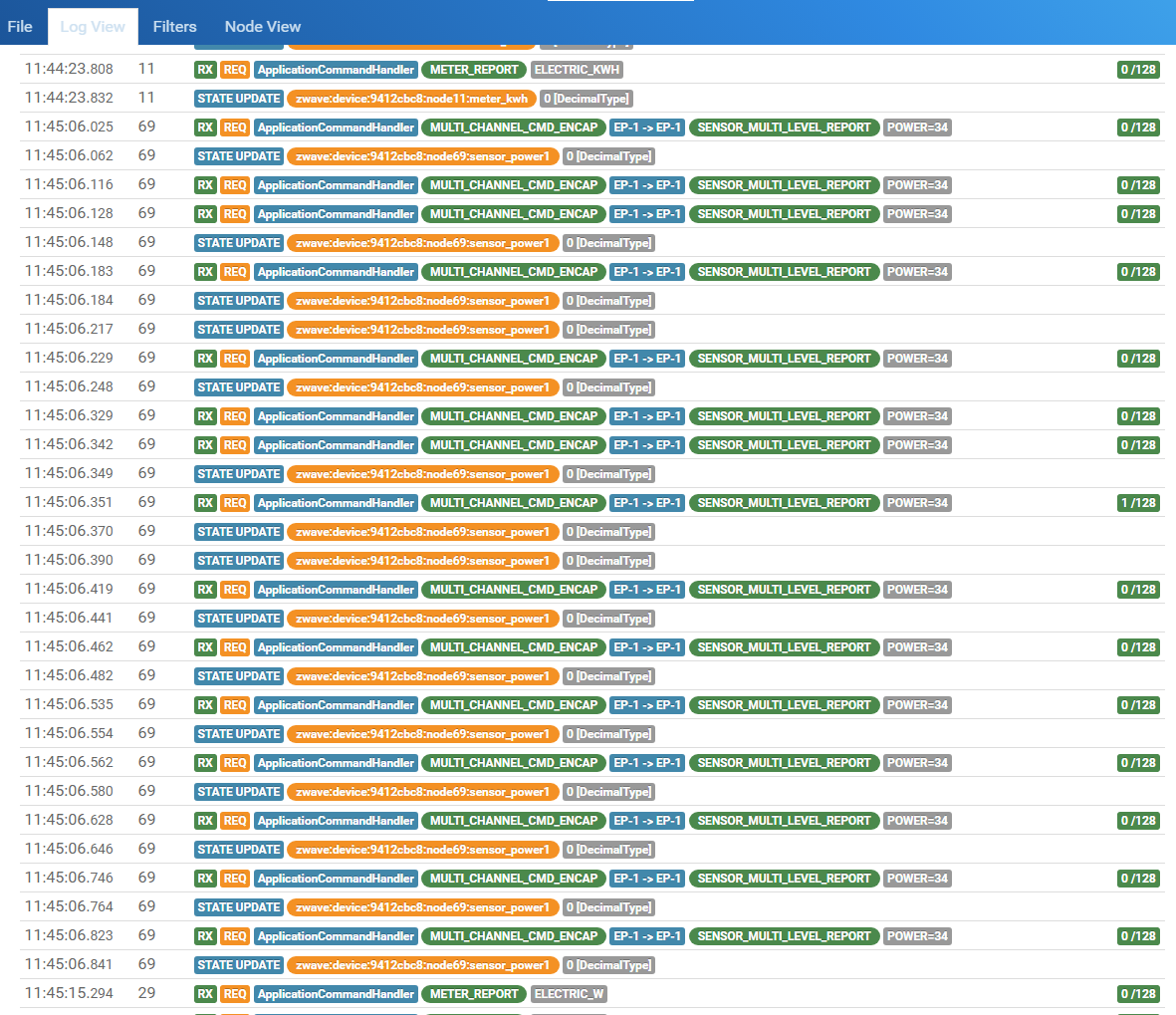

Node 69 (a Fibaro dimmer) again with power updates…
In each case the things are set to default settings, one association etc.
I have excluded and re-included some to see if that makes any difference over time. Any other thoughts? Could this be something generically wrong with my z-wave binding? Wondering if I missed something or did something wrong when updating to the latest version of OpenHAB?
The binding appears to be sending this data unsolicited, so this is highly likely to be a problem with the device, or possibly the device configuration.

I don’t see any way that it’s possible for the binding to be doing this. The binding is clearly not sending anything at all in these logs - only the device is. This sort of error can also occur if a device in the network is not receiving properly as it can cause other devices to resend messages at the network layer (which the binding has no visibility of as that is all handled by the controller itself).
Not suggesting it’s the binding @chris, just that something odd is happening to get this from so many nodes. Node30 seems to be quiet now, so perhaps I do need to do a reset on most of my modules here… I’ll reset another and see if the same applies.
