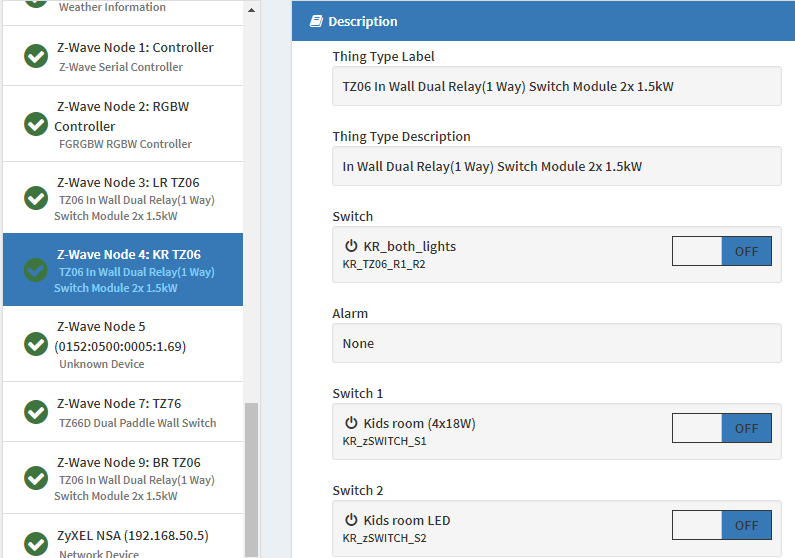

Hi Guys,
I’d like to ask if someone is using TKB TZ06?
The device looks similar to Philio PAN06 and even works with its xml with a small modification: https://raw.githubusercontent.com/div-co/home_automation/master/openhab/zwave/tkb_tz06_0_0.xml
I’d appreciate if someone could have a look at the xml and provide a feedback if it’s fine to be used like that or I’m missing something.
I’ve tested it with both 2.1.0 and 2.2.0 zwave bindings and it works well so if there are no major concerns about the xml I’ll try to go through DB update/submit process.
Dimitar

Guys, is there someone who would like to review TKB TZ06 xml and to update the DB?
tkb_tz06_0_0.xml

DB update request created for TZ06 .
