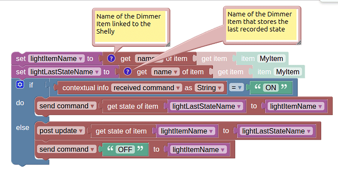

In Blockly the code would look something like:
