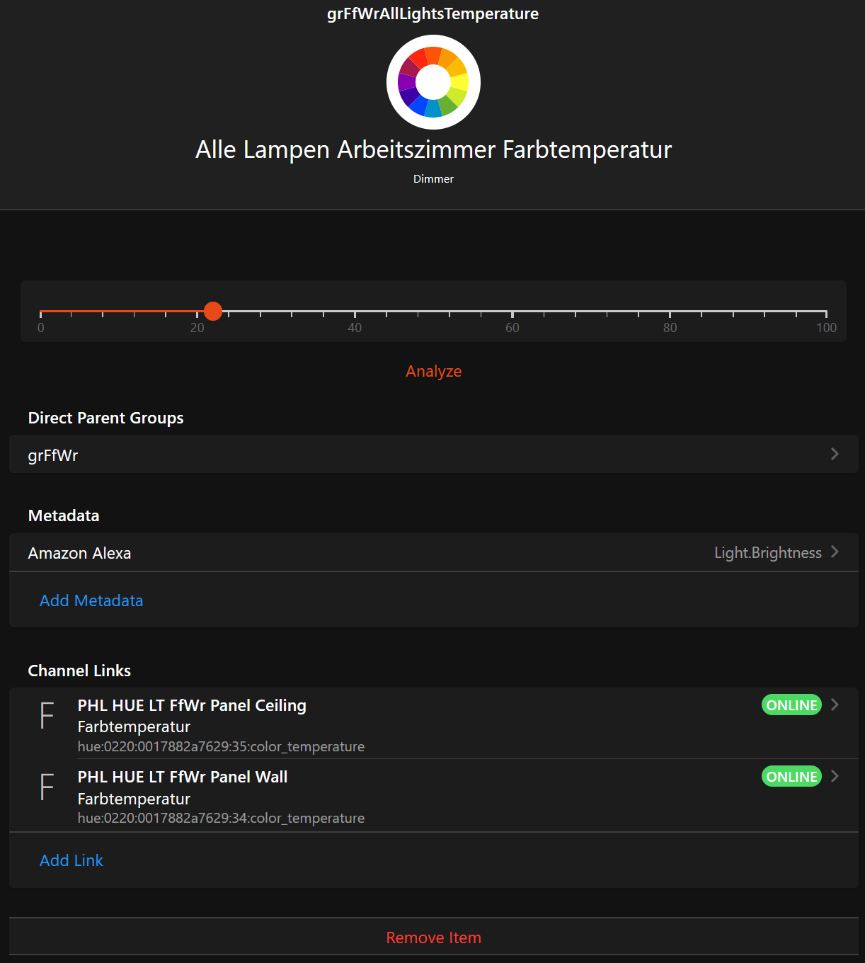

I’ve a non semantic group which I created on the items page:
(I hope, it’s not related to my problem, so I’ll just mention it as a sidenote: I configured Amazon Alexa metadata as Light.Brightness because Light.ColorTemperature did not work for me although I selected Hue as vendor)
Right now, I’ve added two links in order to try approach 2 which I mentioned above. But I also removed the two links for testing, I still could not add my two lights to this group.

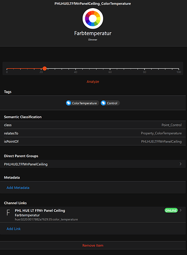

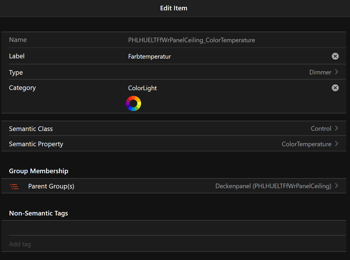

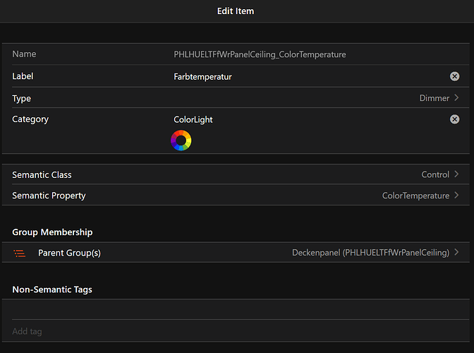

This Control “Farbtemperatur” is configured this way:
As you can see in the details, it has a single parent group:

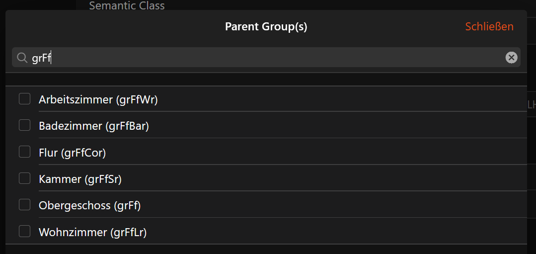

When I try to add the initially shown group grFfWrAllLightsTemperature, the group cannot be selected:

grFfWrAllLightsTemperature shown is not a Group, it is a Dimmer type Item (with links to two channels).
Have another try at creating an Item of type Group.
Thank you both for your support! Sometimes it’s so obvious but one doesn’t see it. Guess I was convinced by the naming :wink: I think, I still have to get used to working with a UI instead of item files again. (I know, it’s still possible to work with item files, but I wanted to try the new way)
Now it works like a charm for brightness and color temperature! (as of different groups using AVG aggregation)
That Item isn’t a Group. It’s a Dimmer.
