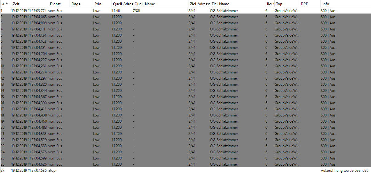

Hello this is my 2nd try to switch to openhab and now it looks almost good. Sometimes i feels a litle bit slow, so i have looked on my ETS and seen a lot off Messages in my KNX Bus.
ID1= i pressed a butteon on my Device (ok)
ID2 to 26 = Openhab sends a lot Messages (???)
The Address 2/0/41 is on 5 Devices. if one is used i switch 2 Lights on/off (via Modbus device).

if i disable 4 of my 5
Type switch-control : OG_Schlafzimmer “OG_Schlafzimmer” [ ga = “2/0/41” ]
i get a better result in my ETS-Monitor
knx_IO
AND alle 5 Buttons are Working! Very nice.
so i enabled all 5 of my 5 Elements again to check.
Everything Looks good and ETS-Monitor Shows only one OpenhabMSG. Strange.
After restarting Openhab, without changing my config, i geht the spam again.
Is this a bug?
