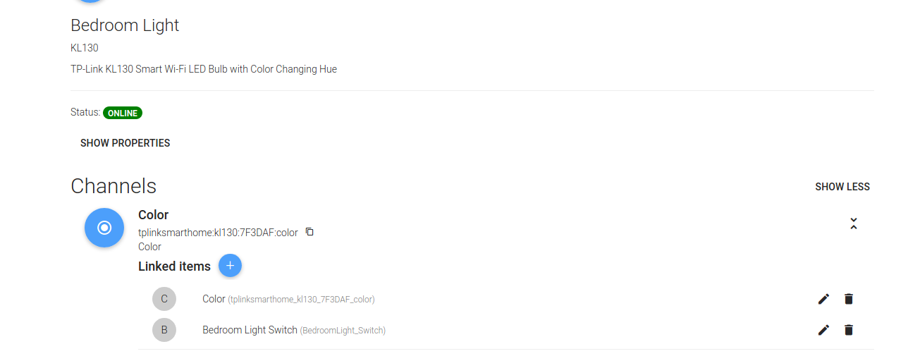

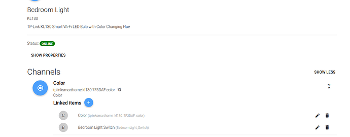

I think I figured it out, though I don’t really understand it.
The key was JustinG referencing the errors in the logs. When I read the logs more carefully I saw that the system was not able to resolve the item type.
I had created all of the things and items using autodiscovery and Simple Mode in Paper UI, but the items created by that process were only recognizable to Paper UI for some reason. When I manually created the linked item through the Thing’s interface then it began working.
