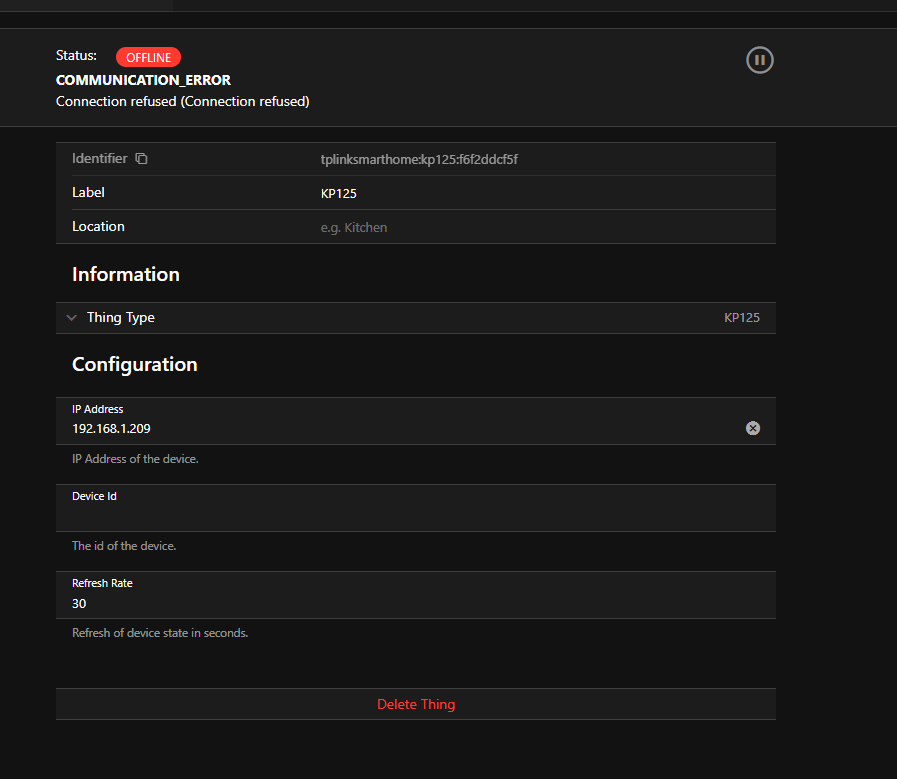

I tried installing the TP-LInk bindings (both regular and the beta seperately) and neither of them can Scan and find these devices.
So I then I set a static IP and add it manually but I keep getting Communication Errors.
I even tried setting a dummy Device ID as suggested in other topics, or just leaving blank…but still the same issue. Also tried adding as KP-115 as others suggested and still no luck.

openHAB doesn’t support Matter yet. So if you’re unable to add that device through the Kasa app without Matter, it’s not going to work.
I actually do have it working correctly in the Kasa app and was able to add it just using wifi in the Kasa app without matter.
Okay, that’s good to know. If you can’t trick openHAB into thinking it’s a similar device, it might have a different way of communicating that’s not compatible with the binding. I’d suggest seeing if it has been requested in GitHub, and opening an issue if not.
Damn…looks like these new devices don’t use port 9999 like the older TP-link devices (which I’m guessing is what the binding is looking for)

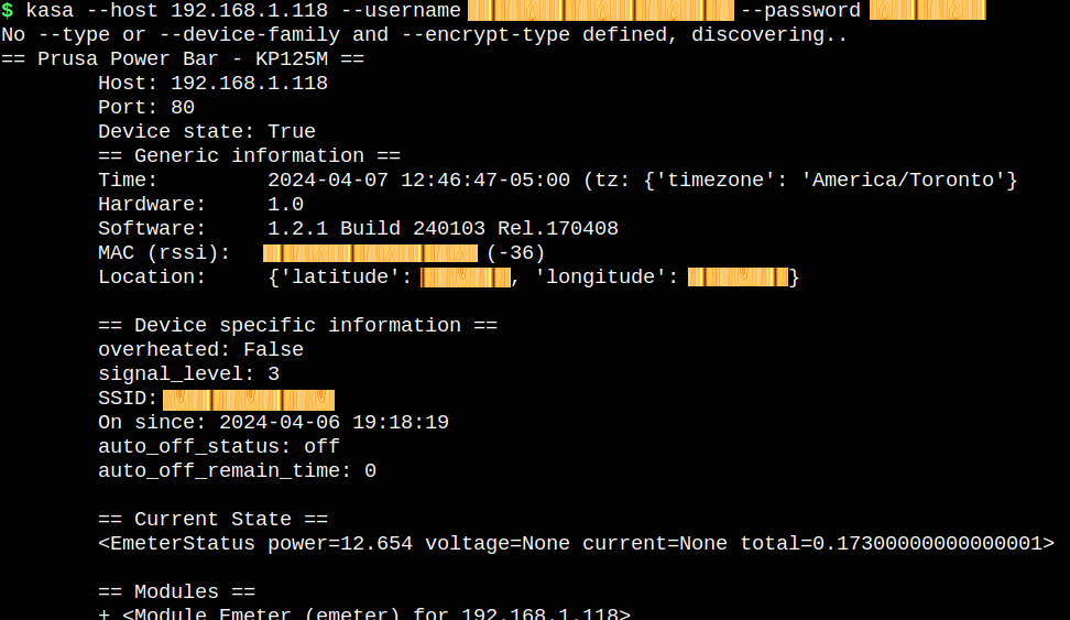

Looking around I see that python-kasa has added support for the KP125M. Not sure if this can help the TP-Link binding to be updated for K125M integration.
I have installed python-kasa on my laptop to see how it works but haven’t got the M querying working yet, the documention needs a bit more clarity for me…
https://github.com/python-kasa/python-kasa
Craig
I was able to use python-kasa to discover my KP125M. It was throwing a fit parsing the password I originally created for the Kasa app so I changed it to something somewhat simpler and it is now working.
