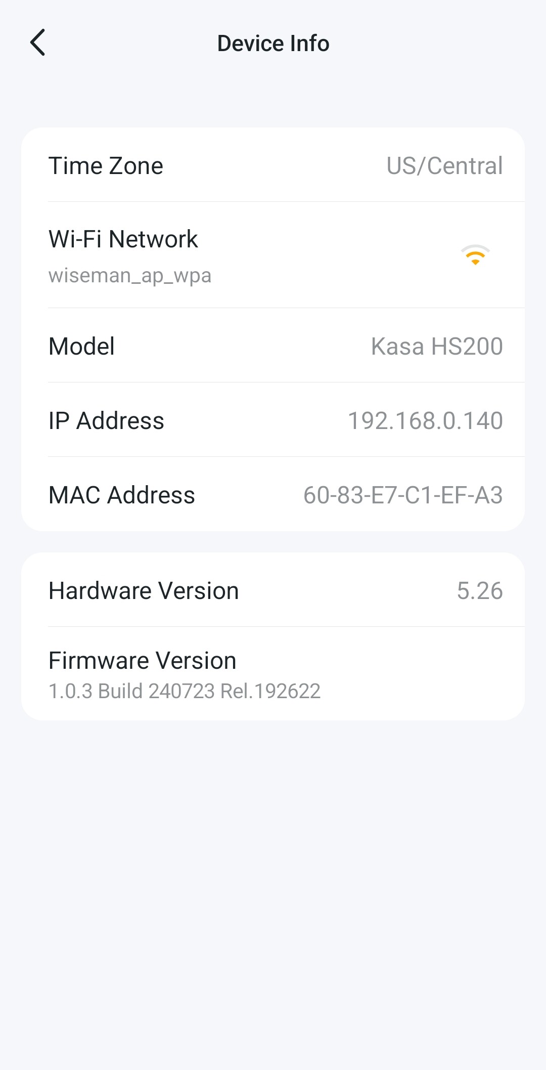

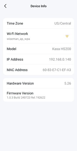

Here’s what the TAPO app has for the switch I’ve been focused on with this thread.
Not sure why your binding version isn’t working unless it has something to do with the Model being passed which doesn’t match which would make no sense because the L510 used works which is the wrong model for the HS200.
