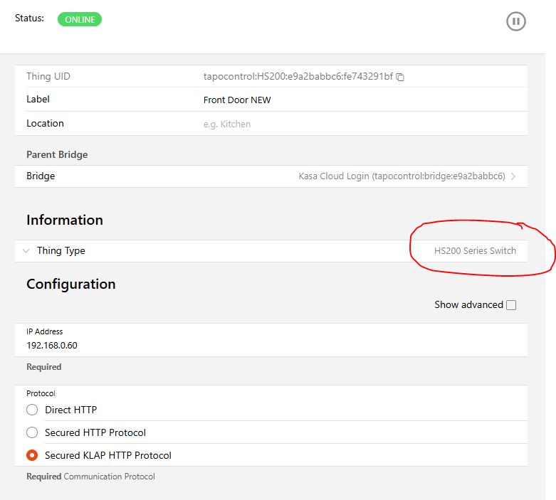

Recreated each THING with the proper HS200 Thing now. Still getting these which is strange based on HS200 is found and is setup as.
19:25:42.440 INFO openhab.event.ThingStatusInfoChangedEvent Thing ‘tapocontrol:HS200:e9a2babbc6:be91c80ca6’ changed from OFFLINE (CONFIGURATION_ERROR): found type:‘HS200’ with mac:‘60-83-E7-C1-EF-D1’. Check IP-Address to ONLINE
19:25:42.468 INFO openhab.event.ThingStatusInfoChangedEvent Thing ‘tapocontrol:HS200:e9a2babbc6:d427645749’ changed from ONLINE to OFFLINE (CONFIGURATION_ERROR): found type:‘HS200’ with mac:‘60-83-E7-C1-FA-EC’. Check IP-Address
19:25:42.471 INFO openhab.event.ThingStatusInfoChangedEvent Thing ‘tapocontrol:HS200:e9a2babbc6:d427645749’ changed from OFFLINE (CONFIGURATION_ERROR): found type:‘HS200’ with mac:‘60-83-E7-C1-FA-EC’. Check IP-Address to ONLINE

Your Tapo binding, trace on with ONE HS200 setup (device → a583090fcf) (does NOT work)
tapocontrol:HS200:e9a2babbc6:a583090fcf
TAPO Your Binding using HS200 Thing.log (196.6 KB)
Still with the ONE added HS200 Thing, still getting these in the OH Log Viewer every 30 seconds.
09:22:02.548	INFO	openhab.event.ThingStatusInfoChangedEvent	Thing 'tapocontrol:HS200:e9a2babbc6:**a583090fcf**' changed from ONLINE to OFFLINE (CONFIGURATION_ERROR): found type:'HS200' with mac:'60-83-E7-C1-EF-A3'. Check IP-Address
09:22:02.571	INFO	openhab.event.ThingStatusInfoChangedEvent	Thing 'tapocontrol:HS200:e9a2babbc6:**a583090fcf**' changed from OFFLINE (CONFIGURATION_ERROR): found type:'HS200' with mac:'60-83-E7-C1-EF-A3'. Check IP-Address to ONLINE
