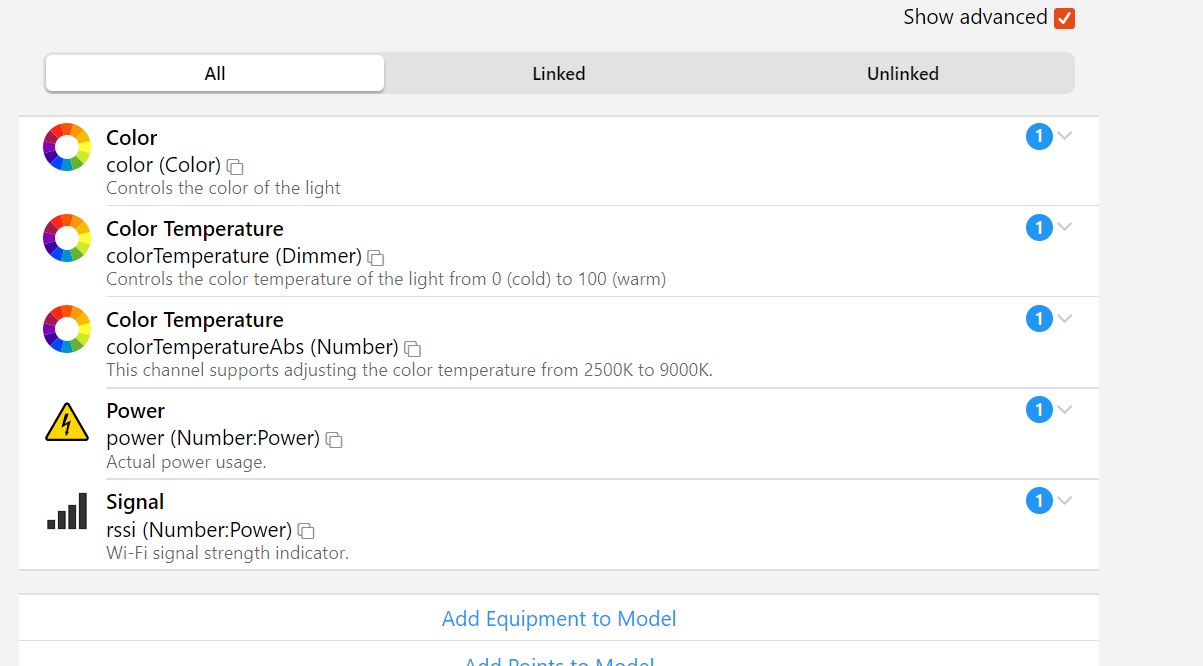

Problem with TP-LINK LB130 lamp/bulb
I’ve created the Thing in the UI, but there isnt a channel for power/dimmer. am i missing something?
From the documentation of the binding:
Switching, Brightness and Color is done using the
colorchannel.
