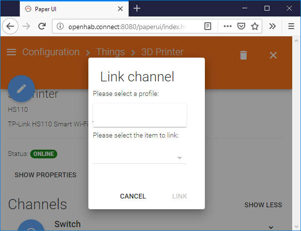

I have a number of HS100 and HS100 TPLink smart sockets that I’m trying to automate through Paper UI and Node Red. These are being automatically discovered correctly, but I cannot connect items to the ‘Switch’ channel. When I try to do so through the paperui interface there are no choice to select for the profile. Upon submission the item is created, but it is not linked to the channel.
I had a dig through the http traffic and I can see a call to http://openhab.connect:8080/rest/profile-types?channelTypeUID=tplinksmarthome:switch which should return the profile options, but it is returning only an empty array:
If I enable simple mode to automatically create items then the item creation and linking works perfectly, except that I cannot edit the item to assign it to the groups I need it to belong to.
I have tried the bundled binding, and also the beta version available through the Eclipse IoT marketplace, but both behave identically.
Are there any workarounds to force the profile options to become available? (Or to force my groups into the automatically created items?)

It should not be a problem of the binding because the binding doesn’t do anything with profiles. It’s on another abstraction level. So installing other versions is not going to make a difference.
Adding another transformation didn’t help. It appears on the other channels, but still no options are available for the ‘Switch’ channel. Where would be the right bug tracker to report this?
In the meantime I think I’ll transition to creating items in files. Paper UI still seems to have too many limitations in this area.
Can you restart openHAB and see if there are any errors reported in the log file?
Before reporting it would be helpful if we can determine if this is a real bug, or caused by some configuration error or other environment issue. I think the best place to report this is: GitHub - openhab/openhab-core: Core framework of openHAB
