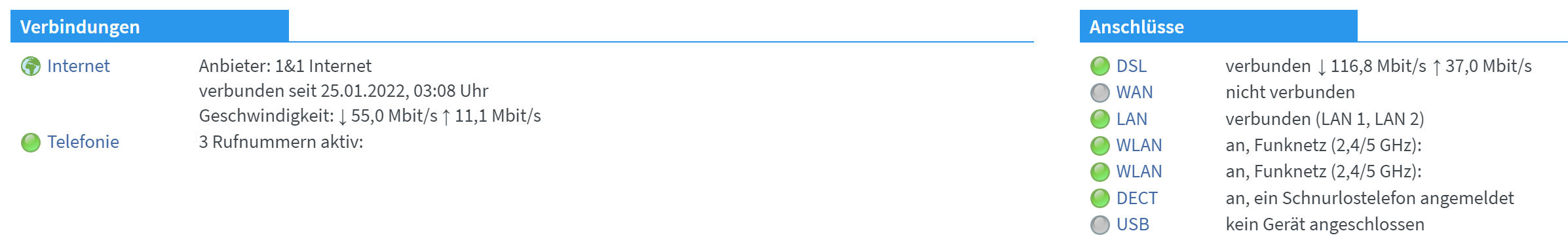

I want to show the dsl downstream in openhab, using the tr064 binding.
This should be 55,0 Mbit/s

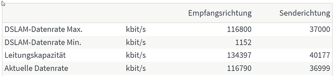

You have 2 downstream rates in your screenshot, one is matching the value provided in current downstream channel.
In my fritzbox both downstream rates shown are the same.

Yes, there are two rates in the screenshot.
On the right side is the capacity of my dsl connection (117MBit).
On the left side is the downstream my internet provider is providing (55MBit), because i’m only paying for 50MBit.
I thought this value should be accessible through the tr-064 binding since it is much more of interest than the theoretical wire capacity.

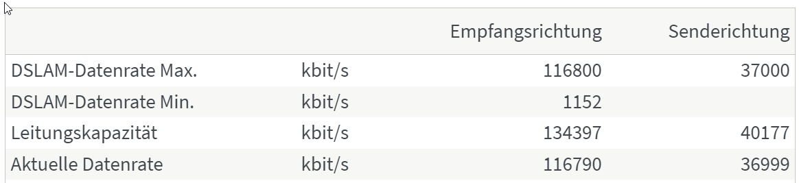

ok, after contacting “entwicklungssupport” @ avm, the values i wanted to get are not part of the tr064 api.
with tr064 you will only get these
the only way to get available down- and upstream seems to do a scheduled speedtest.
