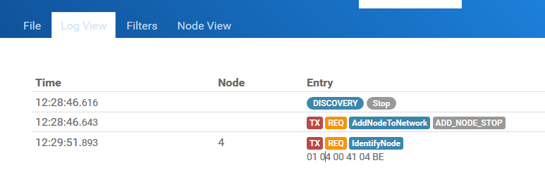

https://www.cd-jackson.com/index.php/openhab/zwave-log-viewer
Best I can tell, there’s an I/O exception getting thrown consistently during the initialization process.
2019-12-07 12:28:21.243 [DEBUG] [wave.discovery.ZWaveDiscoveryService] - NODE 4: Device discovery completed

2019-12-07 12:29:51.866 [TRACE] [nal.protocol.ZWaveTransactionManager] - NODE 255: Adding to priority controller queue
2019-12-07 12:29:51.870 [DEBUG] [nal.protocol.ZWaveTransactionManager] - NODE 255: Added 73 to queue - size 1
2019-12-07 12:29:51.874 [DEBUG] [nal.protocol.ZWaveTransactionManager] - Transaction SendNextMessage 0 out at start. Holdoff false.
2019-12-07 12:29:51.877 [TRACE] [nal.protocol.ZWaveTransactionManager] - getTransactionToSend 6
2019-12-07 12:29:51.881 [TRACE] [wave.internal.protocol.SerialMessage] - NODE 255: Creating empty message of class = IdentifyNode (0x41), type = Request
2019-12-07 12:29:51.885 [TRACE] [wave.internal.protocol.SerialMessage] - Calculated checksum = -66
2019-12-07 12:29:51.889 [DEBUG] [wave.internal.protocol.SerialMessage] - Assembled message buffer = 01 04 00 41 04 BE
2019-12-07 12:29:51.893 [DEBUG] [ing.zwave.handler.ZWaveSerialHandler] - NODE 255: Sending REQUEST Message = 01 04 00 41 04 BE
2019-12-07 12:29:51.896 [ERROR] [ing.zwave.handler.ZWaveSerialHandler] - Got I/O exception Input/output error in writeArray during sending. exiting thread.
2019-12-07 12:29:51.899 [TRACE] [e.internal.protocol.ZWaveTransaction] - TID 73: Transaction Start type IdentifyNode
2019-12-07 12:29:51.902 [DEBUG] [nal.protocol.ZWaveTransactionManager] - Transaction SendNextMessage started: TID 73: [WAIT_RESPONSE] priority=Controller, requiresResponse=true, callback: 0
2019-12-07 12:29:51.906 [TRACE] [nal.protocol.ZWaveTransactionManager] - Transaction SendNextMessage started: expected cmd class: null
2019-12-07 12:29:51.909 [TRACE] [nal.protocol.ZWaveTransactionManager] - Transaction SendNextMessage started: expected cmd: null
2019-12-07 12:29:51.912 [TRACE] [nal.protocol.ZWaveTransactionManager] - Transaction SendNextMessage Transactions outstanding: 1
2019-12-07 12:29:51.916 [TRACE] [nal.protocol.ZWaveTransactionManager] - Start transaction timer to Sat Dec 07 12:29:53 PST 2019 - 2000ms
2019-12-07 12:29:51.919 [TRACE] [nal.protocol.ZWaveTransactionManager] - Transaction SendNextMessage lastTransaction: TID 73: [WAIT_RESPONSE] priority=Controller, requiresResponse=true, callback: 0
2019-12-07 12:29:51.922 [TRACE] [nal.protocol.ZWaveTransactionManager] - STOP transaction timer
2019-12-07 12:29:51.925 [TRACE] [nal.protocol.ZWaveTransactionManager] - Start transaction timer to Sat Dec 07 12:29:53 PST 2019 - 1990ms
2019-12-07 12:29:53.915 [TRACE] [sactionManager$ZWaveTransactionTimer] - Transaction Timeout.......... 1 outstanding transactions
2019-12-07 12:29:53.918 [DEBUG] [sactionManager$ZWaveTransactionTimer] - NODE 255: TID 73: Timeout at state WAIT_RESPONSE. 3 retries remaining.
2019-12-07 12:29:53.922 [DEBUG] [sactionManager$ZWaveTransactionTimer] - TID 73: Transaction is current transaction, so clearing!!!!!
2019-12-07 12:29:53.925 [DEBUG] [e.internal.protocol.ZWaveTransaction] - TID 73: Transaction CANCELLED
2019-12-07 12:29:53.928 [TRACE] [ve.internal.protocol.ZWaveController] - Notifying event listeners: ZWaveTransactionCompletedEvent
2019-12-07 12:29:53.930 [DEBUG] [nal.protocol.ZWaveTransactionManager] - NODE 255: notifyTransactionResponse TID:73 CANCELLED
2019-12-07 12:29:53.934 [DEBUG] [nal.protocol.ZWaveTransactionManager] - Transaction SendNextMessage 0 out at start. Holdoff false.
2019-12-07 12:29:53.940 [DEBUG] [nal.protocol.ZWaveTransactionManager] - TID 73: Transaction event listener: DONE: CANCELLED ->
2019-12-07 12:29:53.942 [TRACE] [nal.protocol.ZWaveTransactionManager] - Transaction SendNextMessage nothing
2019-12-07 12:29:53.945 [TRACE] [nal.protocol.ZWaveTransactionManager] - STOP transaction timer
2019-12-07 12:29:53.953 [TRACE] [nal.protocol.ZWaveTransactionManager] - ********* Transaction Response Complete -- 73 --
2019-12-07 12:29:53.956 [DEBUG] [alization.ZWaveNodeInitStageAdvancer] - NODE 4: Node Init response (0) org.openhab.binding.zwave.internal.protocol.ZWaveTransactionResponse@3e4884
No dice on the factory reset either.
You have filtered the log, this is what is left:
Please show the complete log.
There really isn’t anything else in the log. I let it run for ~10 minutes before and after, and it the only things I cut were a ton of UnifiController handler warnings before and afterwards, and the gigantic list of devices that the node is not, a la Checking zwave:leviton_dzpa1_00_000.
I have otherwise not filtered anything from the logs.
