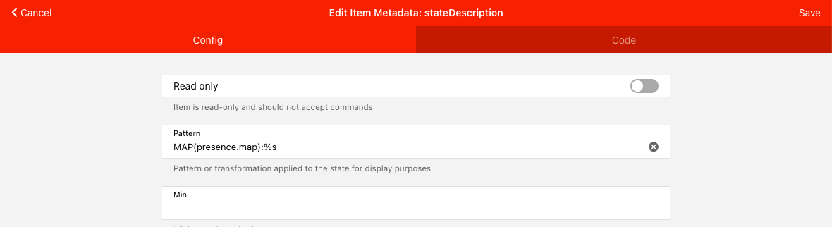

You can continue to use the Map by editing the State Description metadata on the Item. That will use the map to transform the state prior to display.

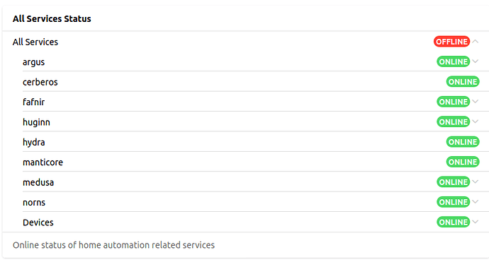

I use it in lists to define a badge instead of just showing the Item’s state.
Anywhere an Item has a widget that is automatically shown, you can define everything about that default widget by editing the “default x widget” Item metadata on the Item.
That was the trick! Thank you.
