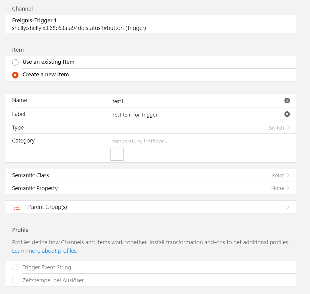

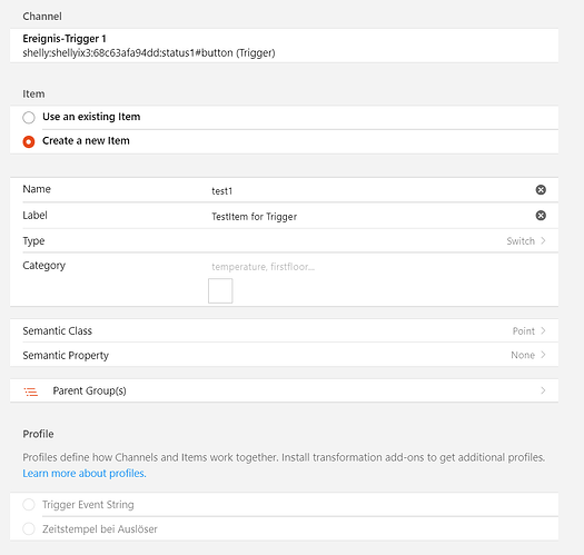

I just tried it. not working. Probably the same problem on your side:
I am not even able to select Trigger Event String
