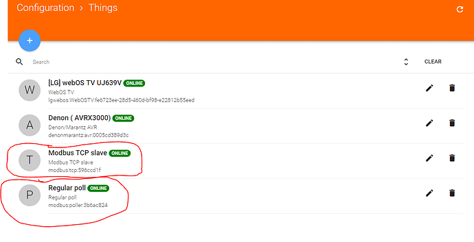

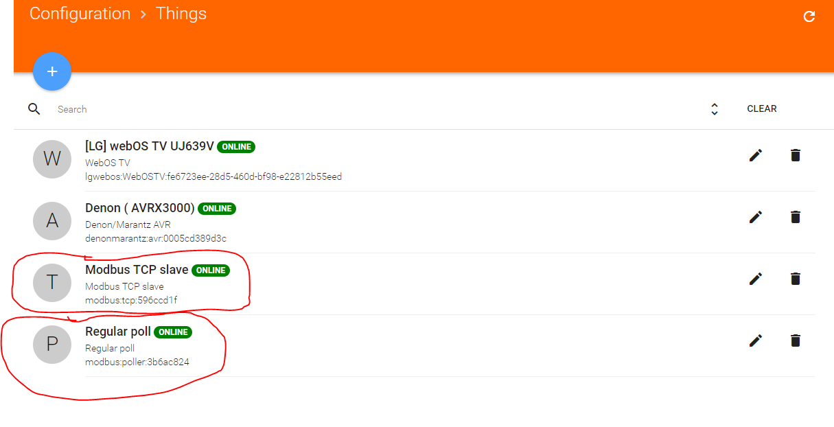

Good evening. There was the following task. I wanted to switch to a new version 2.3 or 2.4 for a long time (since only it already has support for the Modbus2 version). But I came up with the following problem, I was not a professional in this topic, and in the Modbus2 version the approach changed and I don’t understand how to transfer my project. If you can help me, I will be very grateful to you.
New version
http://i68.tinypic.com/2cq0kds.jpg
http://i67.tinypic.com/2czptc.png

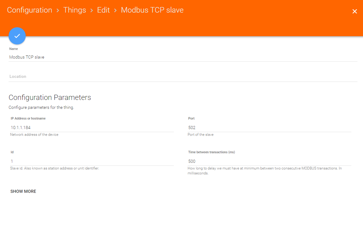

You could not tell me how to adapt it to your code.
for here:
modbus:tcp.slave1.connection=10.1.1.184
modbus:tcp.slave1.length=21
modbus:slave1.valuetype=bit
modbus:tcp.slave1.type=coil
convert to:
Bridge modbus:tcp:ADAM6050_01 [ host="10.1.1.184", port=502, id=1 ]
    // These correspond to input register numbers 00001 - 00012
    // documentation not clear for me, if I use discrete if always start by 0
    // and discrete means read only
    Bridge poller coilsClears [ start=0, length=21, refresh=500, type="coil" ]
        Thing data cl00 [ readStart="0",  readValueType="bit", writeStart="0", writeValueType="bit", writeType="coil" ]
        Thing data cl01 [ readStart="1",  readValueType="bit" , writeStart="1", writeValueType="bit", writeType="coil" ]
Switch ADAM6050_01_CL00             "light-1  [%s]"   { channel="modbus:data:ADAM6050_01:coilsClears:cl00:switch" }
Switch ADAM6050_01_CL01             "light-2  [%s]"   { channel="modbus:data:ADAM6050_01:coilsClears:cl01:switch" }
