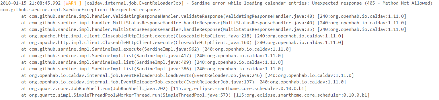

in meantime i’ve tried another calender: https://teamup.com/ks56uvf2mxfpan5uch
Here i’ve got this log (not that i think this will help more without the modified logging config file … but anyway):

I had a chat with Teamup support. They don’t support CalDAV. That’s why OH can’t interoperate with them.
