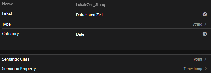

The config of the item should be correct in my opinion.
grafik
The correct config is described here: link
One channel is a string type
The error is complaining about an Item called LocaleZeit. This screen shot is for LocalZeit_String. Indeed this Item appears to be correct, assuming it’s linked to the string channel of the Thing. But it’s irrelevant. That’s not the Item it’s complaining about.
