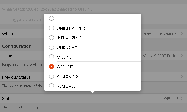

Because I have no idea how to do that. I mean, here are the choices I have in MainUI:
But if there’s a way to trigger on COMMUNICATION_ERROR directly, I’d gladly use that.
I thought the UI would let you type in the status, not just select one from the list (similar to Item triggers).
The COMMUNICATION_ERROR is a part of the status details. You could try changing it in the Code tab to OFFLINE (COMMUNICATION_ERROR) but there is no guarantee that will work.
If it doesn’t, trigger the rule just using OFFLINE. Then you can get the Thing and pull the details from the status.
