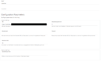

I added the calendar with PaperUI:

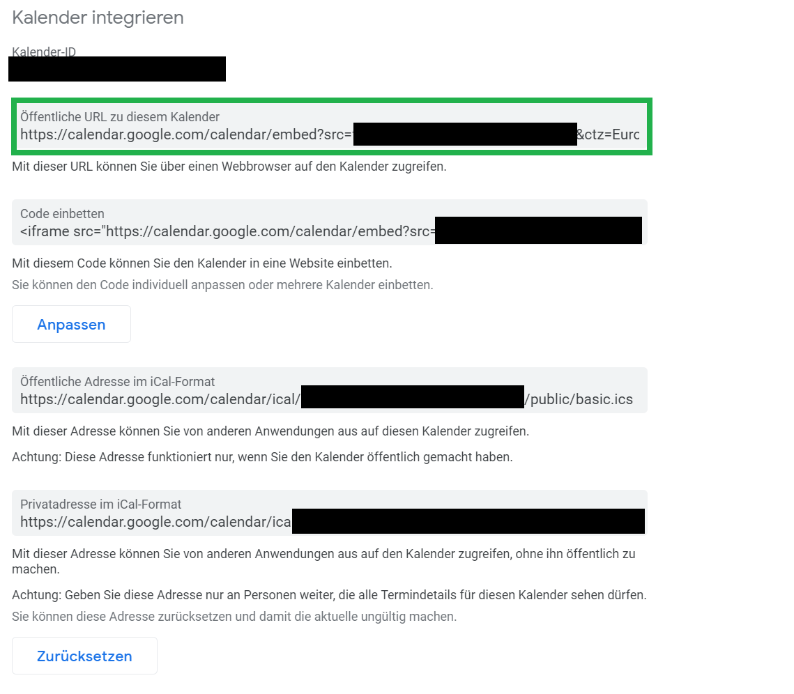

You can find the URL by going to the calendar settings under https://calendar.google.com/
