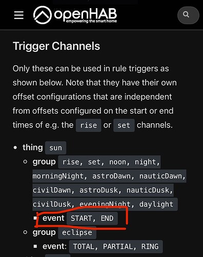

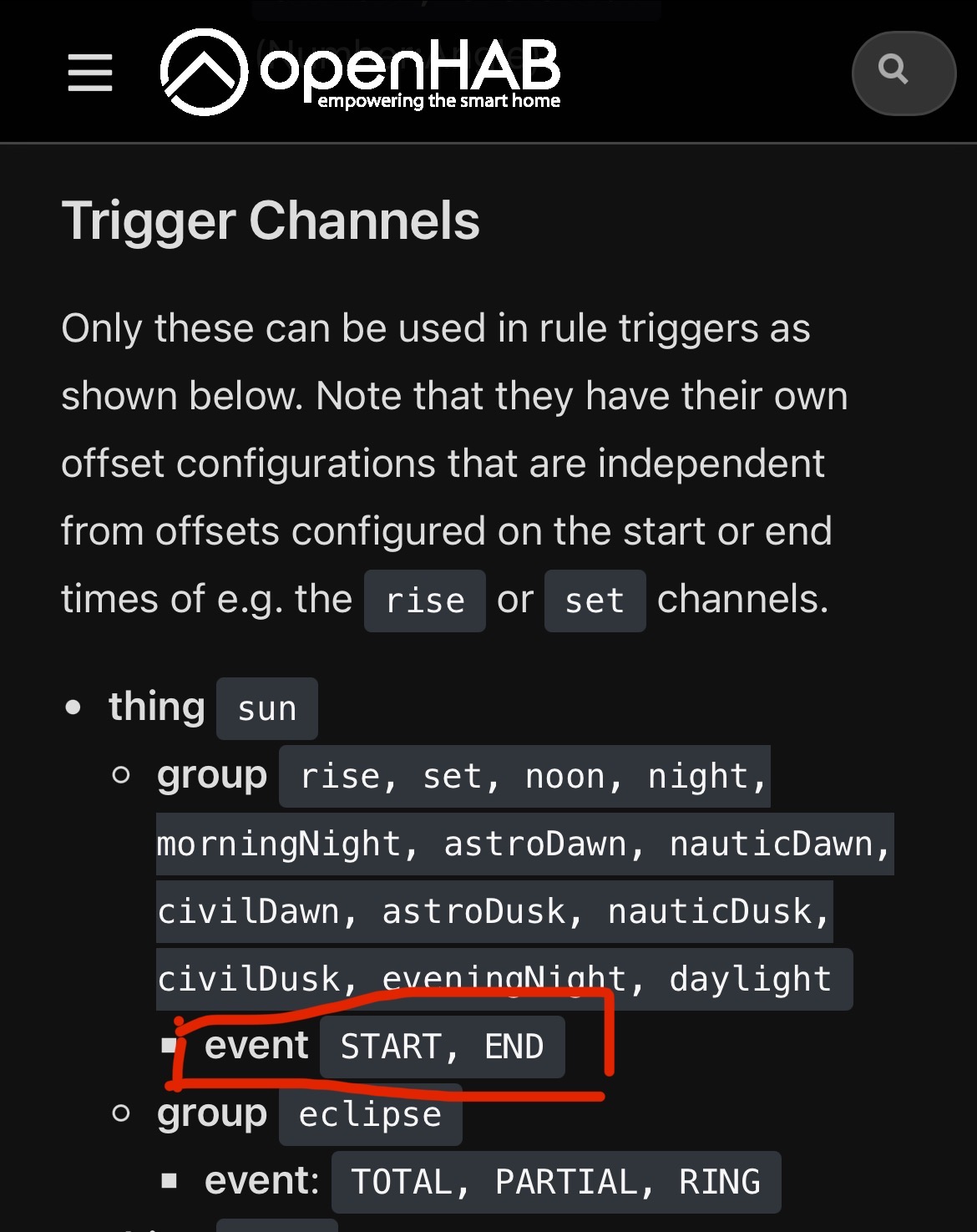

For example, for the Astro binding the sunset/sunrise trigger outputs “START”.

The Astro binding is very clear from my perspective:
